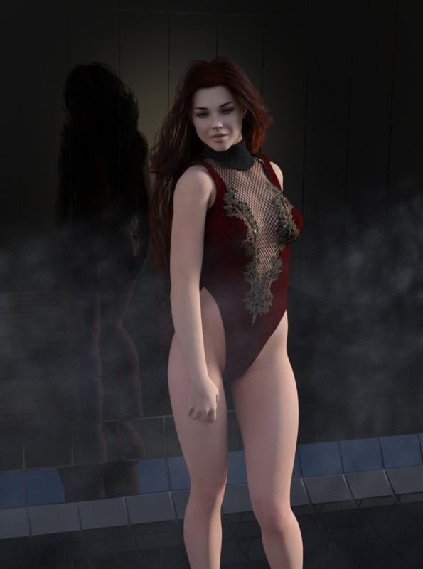

    You'll need to click on the little gear icon in cutout opacity, nonesuch, to bring up the settings dialogue. It is set to use limits by default, with the default limit set to 1.0. I left limits set to on, but changed the upper limit to 3.0, which allowed me to adjust my settings to 2.0. You will need to either remove limits altogether or do similar to what I did to get the slider to go above 1.0. I dropped the image size significantly to reduce render time and the result using a setting of 2.0 was much improved.
    I also stumbled on another factor that should have been obvious from the getgo. The fog prop consists of a complex array of small planes arranged across a surface centred at the origin. In my scene I had used a backdrop positioned a short distance behind my subject figure, with both close to the origin. The camera itself was positioned a relatively short distance in front of the subject. The effect of this was to inadvertently place about a third of the fog planes out of sight behind the backdrop where they didn't come into play, while at the same time positioning some of the planes beyond the camera in front where they, too, were out of play. So, to test the effect, I compressed the fog by reducing the scale along the Z-axis until all the planes were between the camera and the backdrop. I left the settings at 2.0, but, after completing another render I found that I probably could have achieved acceptable results under these circumstances by leaving the settings at the default of 1.0. Of course, that situation would apply only to my particular scene, but it does raise the possibility of achieving acceptable results by playing with the prop scaling, and.or by adding in additional fog props. Bottom line is that the fog will work in Iray and there are options for tweaking that will allow you to achieve a variety of effects.
    The following is the unscaled fog at 2.0:
    595 x 800 - 113K
