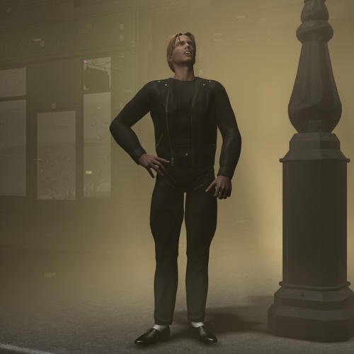

    It is even more visible, when using volumetric cameras and lights with the depth shadow maps,
    like those found in some of the presets available in "Set The Mood"
    http://www.daz3d.com/set-the-mood
    Below is the example DS Pro 4.5 render made with the preset "MoodCamera03 with lights".
    Besides heavy postwork, I do not know of any good solution to remove these "fireflies".
    I have tried moving the camera, but without any significant improvements.

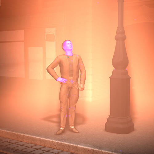

  • ArtiniArtini Posts: 10,900
    Yes, I got one, too.
    1000 x 1000 - 295K
  • KhoryKhory Posts: 3,854
    I think that those are the basic areas I almost always tend to get with a glowing blotch. Maybe something with the translucence or sss and how the light passes through with mapped shadows. Overall not worth dealing with sadly. I much preferred mapped shadows for some types of shadowing.
