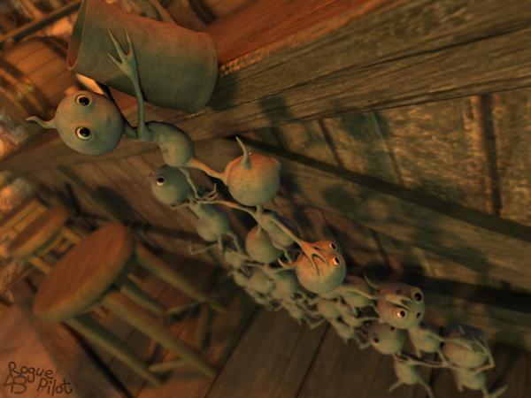

    Here is an example of the difference between raytraced and filtered DOF in Carrara. I know which I prefer to look at but it takes 16x longer to render. I've only really used it on images as straightforward and as small as this where I can balance it against an equivalent time saving in post work.
    1280 x 960 - 168K
    1280 x 960 - 159K

    I like your image, good design!

    btw Rogue Pilot, I like the first one. . . . . . hope that was the raytraced 16x longer one ;-P

    RoguePilot, like Wendy, I like the first image better. I am assuming that's the Raytraced DOF?

    Other way around I'm afraid. I prefer the second one. Just goes to show.
    DOF is an inevitable consequence of the way a camera lens works in Real Life.
    It happens in the human eye too but the brain processes it out. (Best render engine in the world). You have to pay attention to what you're not looking at to see it.
    So, for those seeking reality based rendering, it's not an artistic choice, it's required.

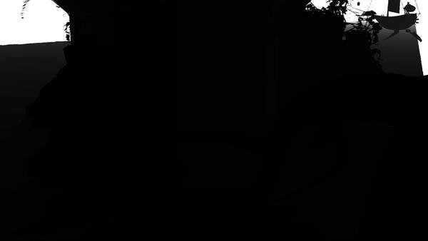

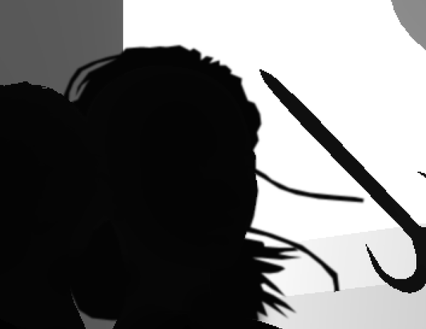

    Well, as I said I haven't done that -- but I understand the principle. I don't have AE at all, but I have used photoshop to batch process frames. It wasn't until a previous DOF discussion on the forum that I seriously tried Carrara's DOF capability. Before that I'd tried the quick Carrara DOF and had been very disappointed, and then turned off by the slow render time of the ray traced variation.
    Even though I didn't set out to do so, the scene I created as a result of the discussion was very good at showing the weakness of relying on depth maps. All I wanted was something that naturally had DOF, not from being forced. Hence using a really great range of depth in the image.
    As it turns out, the greater the range in depth in your image the more useless depth maps (Carrara's "fast" option, or doing a depth map pass and using post processing) are. With a range of only 0 to 255 there just isn't much granularity. If your image has one spot that "goes all the back" (e.g., to the sky) then your foreground will all be a single depth as the 255 gets stretched to whatever value carrara uses for "indefinitely far away" with some middle ground getting the grey in-between.
    To alleviate that, even if the final render will include the background, mask out the background with an object at whatever depth you want as the limit for a depth pass. It requires a separate render with the object, but you can then plug that into whatever post processing workflow you have. From what I understand of AE, you should then be able to select the depth of focus at arbitrary frames and use the depth maps with that. Doing the same with Carrara's "quick" version would require setting the focus depth at those frames, then a full render with a single threaded DOF effect and then reviewing the result to ensure it was good. In AE, the DOF effect is multi-threaded and if you need to tweak the focus depth for a frame its just a fast recalculation rather than a re-render.
    However, if I was doing animation and wanted DOF I would *only* do it through post processing with a depth map. Even if you were fine with taking the first result of the Carrara rendered DOF, it is just too slow (even the "quick" version thanks to being single threaded, the time adds up with the number of frames). I would just ensure that I had usable depth maps :)
    You sure about all that?
