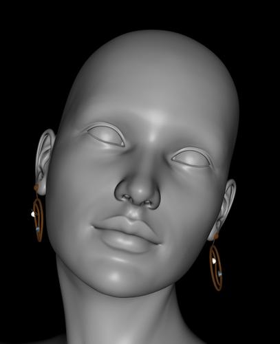

here are two renders which show this.
These are the V4 Honshu earrings I got from SharwCG and turned into a conforming figure.
The left has rigidity applied, the right does not.
One image shows Genesis default, the other Victoria 5 with her head turned.

Nice examples. Yes, clearly it shows no deformation on the earring with the Rigidity map.
Do you find that there are no distortions testing different posing/movements?
Also, where did you place your Reference Group Polygons, and how many polygons used?
