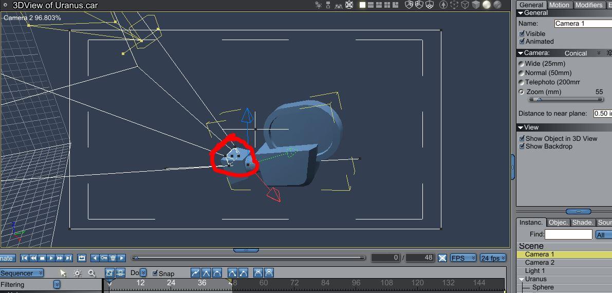

  • VyusurVyusur Posts: 2,235
    John, it's here.
    758 x 656 - 197K

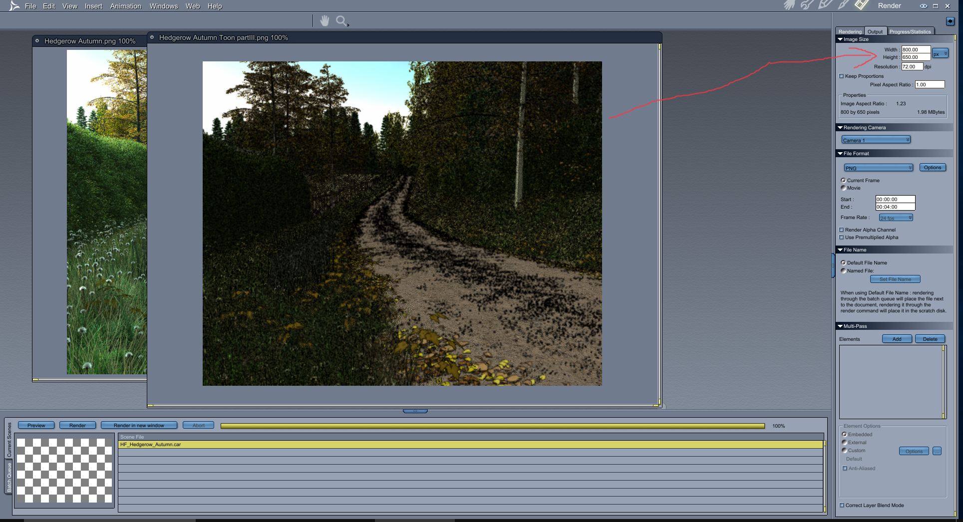

  • Bunyip02Bunyip02 Posts: 9,338
    edited April 2017
    Can you resize the frame in the render room or is it still locked ?
    EDIT: Just reread your first comment, sounds like you have already done this.
    1929 x 1046 - 2M
    Post edited by Bunyip02 on
  • StezzaStezza Posts: 9,204
    wgdjohn said:
    I next created a new Medium scene with nothing in it but the camera and light... now it is resizeable so now I wonder if it is a one time deal and can't be resized later... which makes absolutely no sense to me.
    Most times I have to adjust it before I add anything or very little.... once the scene gets loaded up I can't adjust it either no matter what.
    Which is a pain sometimes if I forget to do it.
    unchecking the "keep proportion" on output tab will let you resize the production frame by dragging the corners.
    iirc, need to be looking through the camera selected on the output tab.
    if you look at the camera from another camera, can see wire frame handles to adjust the production frame of the camera you looking at with the other camera.   + 2 venti cups of java smiley
    the lil teeny tiny wireframe display button
    1231 x 604 - 114K
    1191 x 570 - 107K
