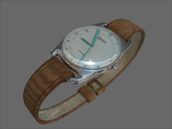

    Also,. here's the last thing I rendered using HDRI ...mainly for the reflections.
    By the way,
    For those who don't already know, 3dage made that watch in the Carrara model room.
    I'm hoping that he'll model the innards, too. when he does, it'll be time for me to buy a 3d printer and make the watch for real! :)
    Great job on that beautiful watch, 3dage!

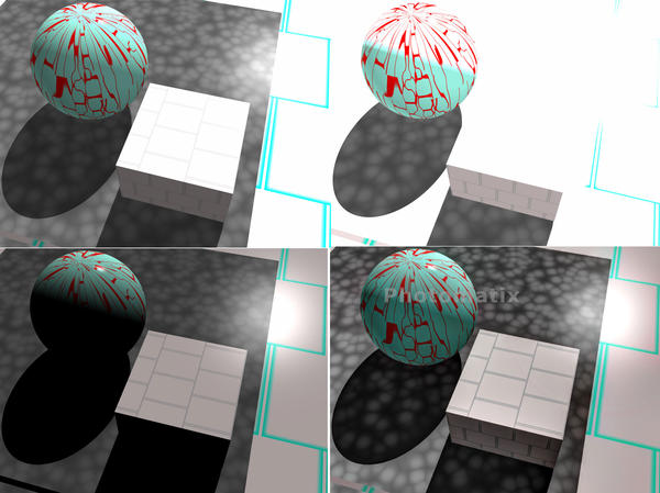

    I am relatively new to Carrara, but I was wondering if anyone else has been experimenting with using HDRI software to enhance their Carrara renders.
    For me....
    It appears that "OP" would like to take three Carrara renders, one under, one over and one currectly "exposed" and combine them in the software he mentioned to produce a HDRI simulated render. This render to be used as the final product - not to be used as HDRI file in Carrara.
    I had a play with a variable ND plane last night and the Photomatix software. The results weren't too bad.
    It's worth investigating if you hav trouble lighting your scenes to get a nice tonal range.
    I have a feeling it would work better in B and W

    Not that I couldn't do the same in PS, but if there is no data in th original image because it was so badly lit initially, then you can't use PS to magick it up. So the various exposures could have a place in filling in detail.
    First three renders all done in Carrara, btoom right blended in Photomatix - as you can tell by the watermark

    This was originally my point. To be more precise:
    (1) Adjusting the lighting for 3-4 various exposures is okay if you have 1-3 lighting sources. It becomes more problematic when there are a dozen or more. On this point, I particularly like the idea of putting a "lens filter" in front of the camera to adjust the lighting. This seems to be the perfect and easy way to adjust the exposure. I have not had a chance to try this, but given my limited knowledge of Carrara, would seem to work. Thx, Head! The "Master Light" settings I was not familiar with. Thanks for that idea also Holly!
    (2) As you mention, PS can't work wonders where there is no data. And since Carrara saves files in 8-bit colors, there are limits to the adjustments you can make. No software (currently developed) can overcome some limitations.
    (3) The end result of what I am looking for are images of greater depth and range in color. Until we can save 16-bit color images in Carrara, I have been examining alternatives that will get me closer to that.
    Hopefully soon, DAZ will obviate the need for such efforts in the near future! :D
