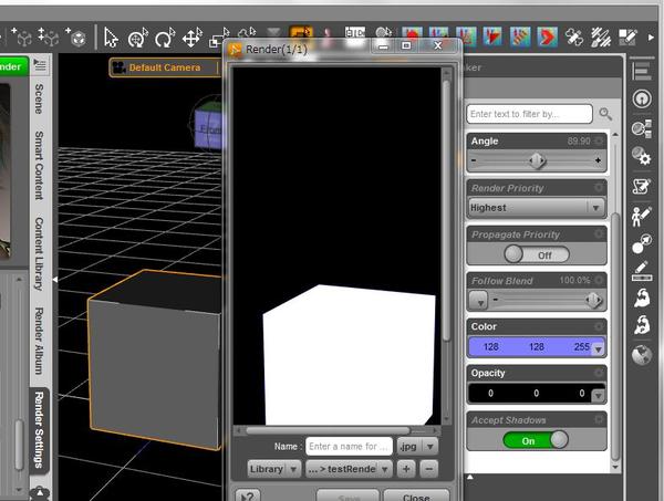

    load root surface blick only,
    it must show the "color" of cube when I render. but on 3d view, it keep grey defalut color.
    shader mixer pleview is transparent. I can not check any color.
    I just load root "surface" blick, in shader mixer, then apply it on cube surface.
    Property "opacity" = "black",
    property "color" = "blue" (or red , yellow green,, white,, )
    in shader mixer preview,, the color disappear.
    om 3d view,, cube keep default surface grey color.
    then render it. = pic1
    everytime,,it show ambient blue property "color" (or red , yellow green,, white,, )
    I want to confirm ,,,the effect of root blicks are supposed to be?
    or there is something problem about video driver?
    but when I set "color" ="black" too, as same as "opacity"
    and render, it transparent, I can not see the black color
    839 x 671 - 86K
    1175 x 771 - 122K

    it shows yellow .(ambient)
    if I set color (128.128.255) (violet) opacity (0.0.0)
    it shows white,,,
    now I render with default 3delight setting(restore default)
    how work color and opacity? :-S or AMD Radeon is so foolish??
    786 x 594 - 84K

    so,, richard said correct result means,
    use only root surface blicks.
    then
    when set "opacity" = (0,0,0)
    the object must be transparent , so nothing can be seen "not black shade of object, no color" ?
    I hope so,,, (though I do not get the effect) .
    I perfectly confused what means opacity,, about root shader..
    I thought,,, root surface blick " color"
    is data of RGB value about each surfaces when I render. if I connect the input color to
    other blicks node, it overwrite the RGB value,,
    about daz default material blicks, there is diffuse, ambient, specular,,
    so that these value are input to "color" of root surface blick when I render.
    is not it right?
    then when I connect "daz default material blick" to "root surface blick",
    I need to connect both output "color" and "opacity" to get transparetn (nothing can be seen)
    but I feel it is something wrong,,
    when I connect daz defualt material blicks output "Material opacity"
    to root surface blick input "opacity",
    it means,, opacity color (opacity strength) value of daz defualt material blicks
    overwrite the "opacity" of root surface blick,,
    then,, if I set the opacity strength of "daz default material" blick,, the surface will be transparent,
    the value of "opacity" which I set in root surface node are ignored,,,
    so I think I need not connect the "material color" to "color" (though I can not use ambient,or specular etc,,)
    to get transparent controll,,,
    but it can not work, as I expect,,
    it is miss understandinig?
    think the opacity value are overwritten by daz default material blick

    I think you are understanding correctly - when you plug an input into a value that replaces the local value set in the brick. So setting the opacity in the root brick to black has no effect if there is an output from another brick plugged into the opacity input. Sorry, I had misunderstood some of your earlier posts I think.

    then I want to ask (sorry again and again,, if you have time,, olease answer later,,, ) and confirm
    use only root surface blicks.(no daz default mateiral brick)
    then
    when set “opacity” = (0,0,0) in surface blick,
    the object should be transparent , so nothing can be seen “not black shade of object, no color” ?
    and,,, when I set opacity strength - (0.0.0) in daz material blick,,
    and I connect opacity material to opacity (root suface blick) only,
    it means,, opacity strength (0.0.0) out put as opacity value then input to opacity of (root surface blick)
    so object should be transparetn when I render?
    transparetn = opacity or opacity sterngth (0.0.0) is right understanding?

    Yes, 0,0,0 in opacity is completely transparent, or it should be. I have put a sphere around a Kid4. The sphere has just the Surface brick and I applied the diffuse colours you used in your tests, i.e. violet and green; and black as opacity. Indeed the sphere comes out whitish, with a respectively blue and yellow green cast, you can see the UberEnv KHPark in the background. That looks like a bug to me, but there may be a valid reason I'm unaware of for that to happen.
