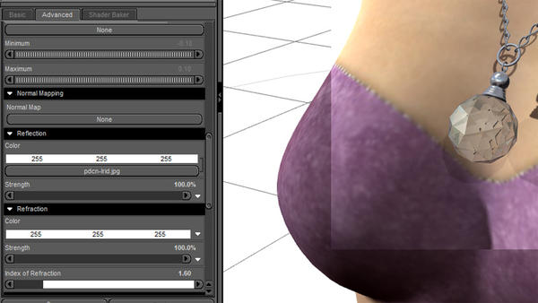

    Moving back just a little, I've been trying to add a "reflection map" to the reflection material (in the absence of a real room setting), but I fail to see any difference.
    Would the result be dramatic and apparent? Or subtle?
    I've tried bright color patterns like has been suggested. I'm not really sure what I should be seeing as a result.
    Thanks!
  • adamr001adamr001 Posts: 1,322
    What's your Reflection Color set to? If it's other than 255,255,255 and you're using a map, you can expect some strange things. Also might want to up the Reflection Strength to 100% and see if shows up well.
  • BagboyBagboy Posts: 173
    Thanks for the quick reply adam!
    Yes, I have it set to 255,255,255. Also tried a lot of different colors to see if that made a difference.
    Reflection strength is also set to 100%.
    I don't see the map attached in the Color channel?

    Sorry I'm blind, I see it now. I'm not sure why it's not working except to ponder what version of DS you're using. That looks old. ^_^;;
    Good eye! I'm using DS3.1Advanced here. Will this idea of a texture map in the Reflection Color channel not work in this version?
    I do have DS4Pro too, but I wanted this to work in the older version too.
    When I saw your earlier post, I thought you meant I needed to put the texture map into the Diffuse Color channel, which made a goofy kind of sense to me. %-P
    Thanks again!

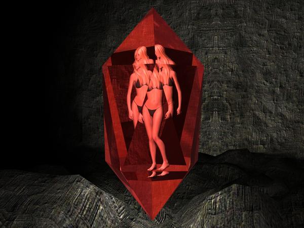

  • RarethRareth Posts: 1,462
    you can also put things inside crystals,
    relfection map is an abstract I did in bryce as a spherical projection render,
    all the other crystal settings are from suggestions made on this thread.
    1024 x 768 - 524K

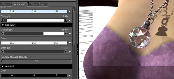

    Meanwhile, I think I'm getting closer! What I found was, in the Specular channel, turning OFF the Multiply Through Opacity gave me more expected results.
    I'm not exactly clear what the Multiply Through Opacity would be used for, or why. Probably as I go through these settings and gain more familiarity, I'll figure it out.
    I'm not even sure I'm thinking of this crystal shader correctly, but I think it is reacting better.
    Thanks again Adamr!
    Wow! :gulp:
    So you did a spherical render of the scene with the figure and then wrapped that image around your crystal in the Reflection channel?
    Do I have that correct?
    Very cool!

    Oh yes! Turning off Multiply through Opacity is a must.
