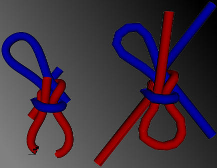

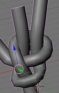

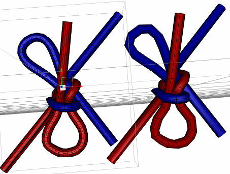

    First attached image is a DAZ Studio 3 screenshot of the imported OBJ (right), and the same imported OBJ with SubD applied (left).
    Second image is a DS3 render - the SubD smooths it nicely (the errors in the render are 99.9% certainly my model!)

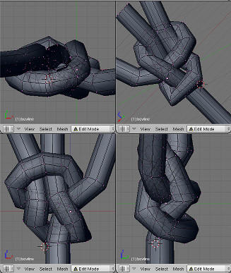

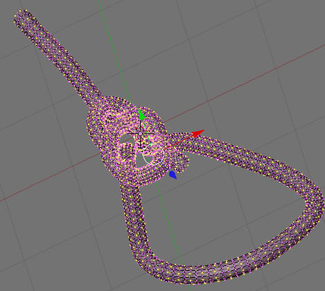

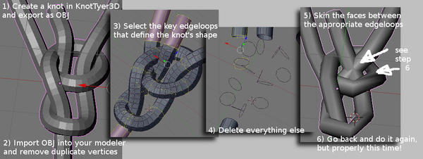

    Thanks Wendy! Spotted the 'Save As OBJ' now. Okay, loaded the exported bowline OBJ into Blender - looks nice, but a bit loose:
    - it's using an 8-vertex circle rope profile. Great, just what I want.
    - There's loads of duplicate vertices (that'll be the problem you had). Doing a 'remove doubles' in Blender deletes 4240 of the 5664 vertices, leaving 1416.
    - Multires/SubD works fine after removing doubles (see attached image), so you need to do the equivalent when you import into Silo.
    I have an idea that deleting all except a dozen or so of the key circular-profile edge-loops, and then connecting the remaining ones back together (skinning the edge-loops is Blender's term for it iirc, not sure about Silo), will give a nice low-poly mesh that'll be quite easy to tighten up...
    469 x 419 - 63K

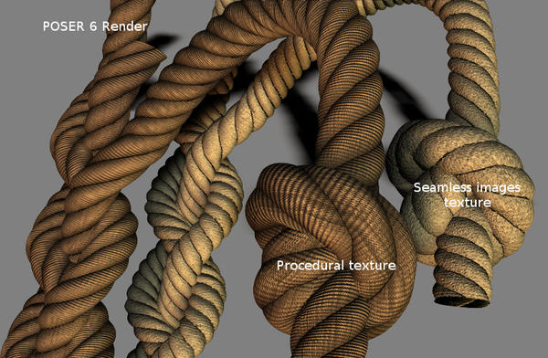

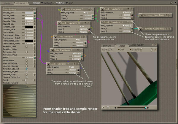

    The one in the Railings02 freebie I recently uploaded. Nothing fancy or clever, just a simple equation based around the sine function... f=abs(sin(50U+5V)) .
    Here's a screenshot of the Poser shader if you just want to do it yourself. There's a bit more info about ways to do the shader in DS here, and there's a DAZ Studio version in the freebie too.
    1078 x 751 - 244K

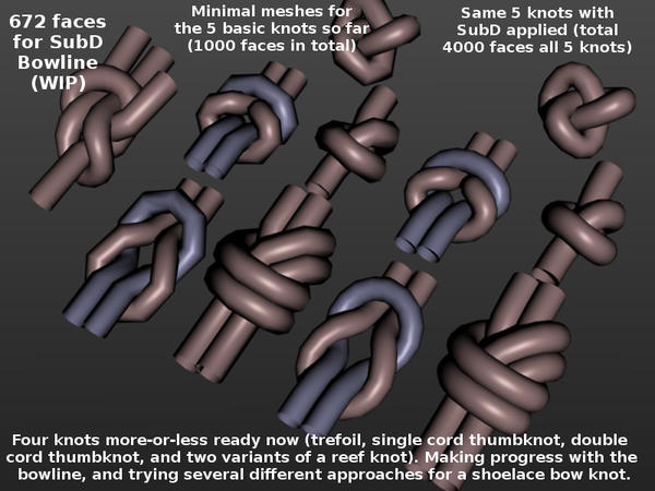

    edited March 2013

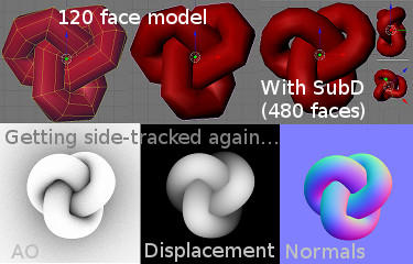

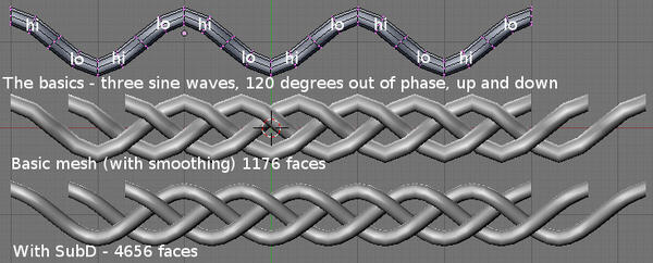

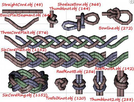

    Back on the knots now! A basic trefoil knot* using 120 faces. With one level of SubD (so 480 faces) it looks quite nice (although the SubD opens up some gaps. Still, that's easy to fix by moving the outer loops toward the centre.
    I just realised that I can use the same method I used for mail armour to create bump/displacement, normal, and AO maps for each knot. Another possible way to add knots to clothing perhaps? For the Blender-baked images in the bottom row of the attached piccy I tightened up the basic 120 face knot and then added a few levels of multires - just to see how it looks...
    List of knots already started and how near completion each is:
    - Double cord thumb-knot (as per first post): 90%
    - Single cord thumb-knot: 90%
    - Trefoil: 90%
    - Bowline: 75%
    - Simple bow/shoelace knot : 50%
    - Reef knot: 50%
    I'll try to upload this batch by the weekend...
    (suggestions for more knots still welcome)
    *Not the sort of knot that's easy to tie in the real world!
    375 x 240 - 37K

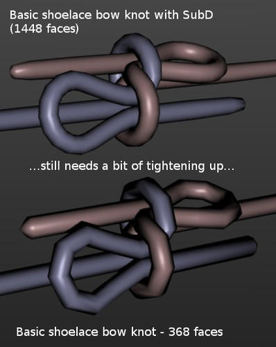

    ...and here's the basic shoelace bow knot. Still needs a fair bit of adjustment.
    423 x 531 - 39K
