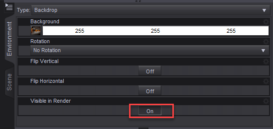

    Was this ever figured out? Because I have the same issue. My backdrop image shows fine in the viewport but doesn't show in the render. What settings *for sure* usually need to be on for it to work? I have "draw dome" and "draw ground" set to off, since I don't want the dome to render.

    There is this setting, I imagine that some kind of error somewhere in DS settings files or wherever might keep it in Off mode (may possibly happen even it it says On in DS).  Toggling the setting may possibly fix it, I have seen this in other contexts.
