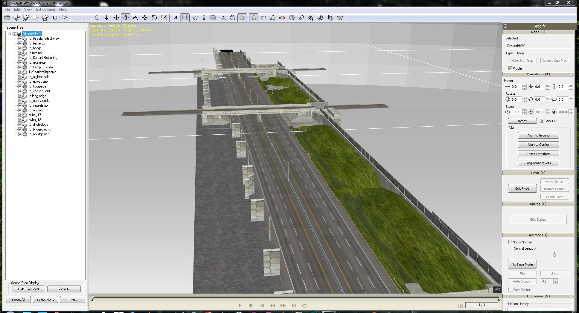

    OK I have found a solution
    Dimension 3D's DSON loader Python imports it into Poser correctly and I can export an obj for iClone
    I need to put it in the map folder (or copy the maps to obj location) but yes loads corrected
