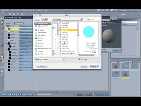

    I was following along a Make Your Own Particles tutorial by Cripeman and it appears at this point in the video (2:10) that he simply inserts the plane parallel to the Front plane without doing any obvious rotation.
    I suppose he could be performing some kind of keyboard shortcut.
