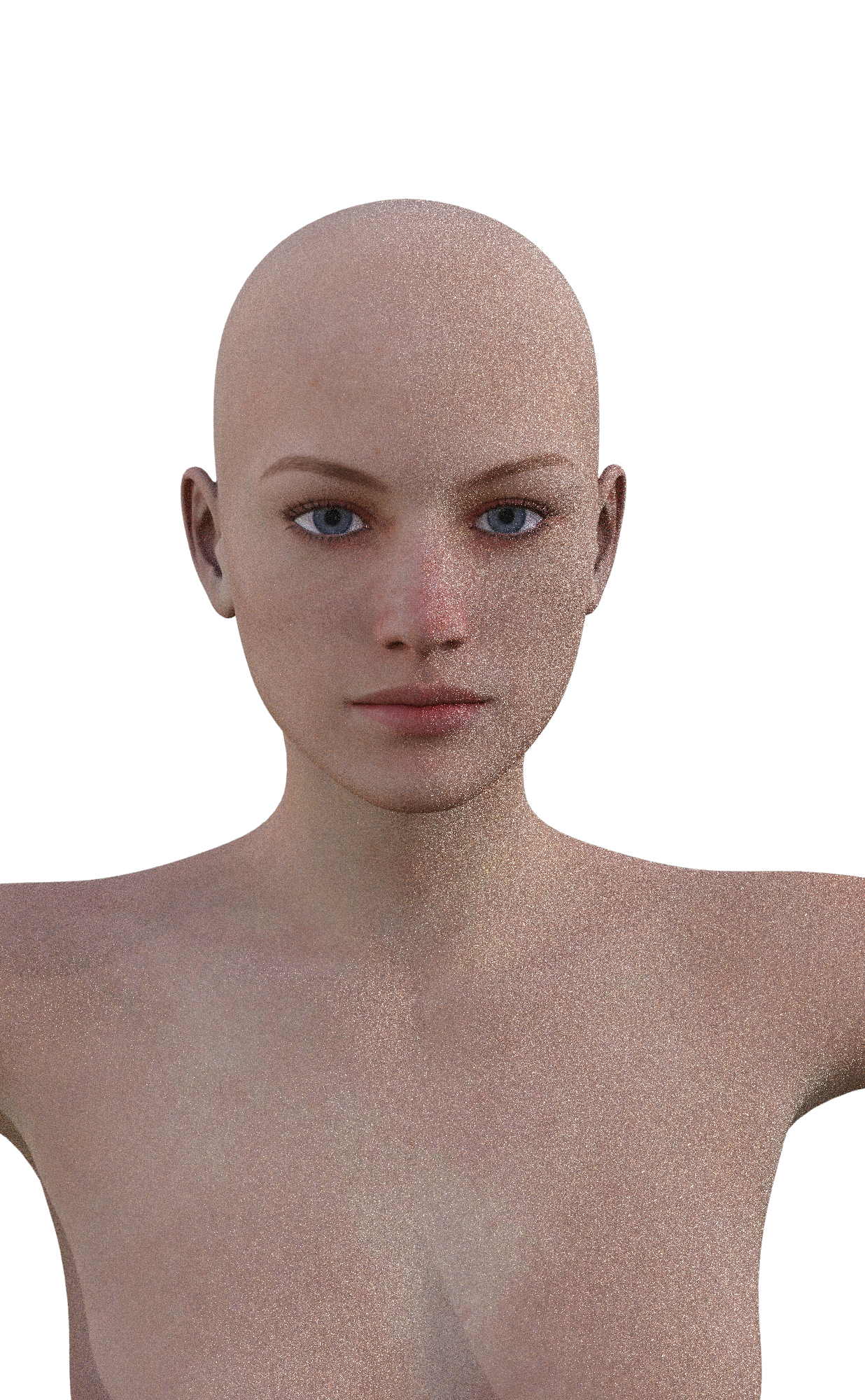

    Thank you.  Unfortunately that isn't finding enough to fix it. For some reason V6 is partially loading with the base Genesis 2 female which it has never done.  However, zeroing those out does not bring it back to the base female.  And when I try and apply a different character, the face distorts rather badly.  Haven't made any changes to her so not sure what is going on all of a sudden. I can zero the figure but I can't apply any other figure shapes to the zero'd figure, as it also distorts.
    This is what I have the base figure with the v6 zero'd out.  And then the base figure zero'd which looks like it should but won't take morphs correctly.

    Interestingly, I can dial a character in once I zero the figure but I can't use the preset actors or one click shapes.  Might just have to uninstall and re install and see if that fixes it.  Not sure where else to look.
