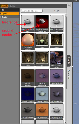

I have never really used lighting presets before, I just tend to add distant lights, spots etc.
So I tried using Uber environment, but I must be doing something wrong as it gives really weird results like this...
Does anyone know if there's a video tutorial on lighting and stuff?
1275 x 725 - 67K

thanks. Not sure it does. Here's the steps I took to create the two images i just posted..
Loading the Base first is fine. When you load the GI version, hold down the Ctrl key, and choose 'Add' from the dialogue box. GI will add massively to render times.

No, you don;t need the base for GI, it will allow you to load it, but you will need another light in the Scene as well, the help file tells you all of that, under GI at the bottom.
Most of the other presets will generate an error if they need the Base light first. Shader lights are a massive subject, and there is a bit of learning required in order to use them properly. I will leave it to someone else to explain it more fully.

The mottleing can be fixed by going to the Parameters pane, and turning up the Occlusion Samples, this is rendered with the OS set to 256, and the Shading Rate set to 10.0. Base light only. Using the other option with shados etc, can take a very long time.
Render times are increased drmatically using these shader lights, but they produce really good renders.
Ok, I first clicked on the Base, then CTRL clicked on the one next to it, but it gives me a dialog box
See my previous post. Change Replace All with Add.
