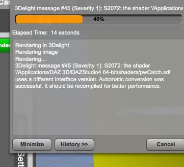

    4. - i am posting something i captured when rendering - might be helpful
    3Delight message #45 (Severity1): S2072: the shader'/Applications/Daz 3D/Daz studio64-bit/shaders/pwCatch.sdl' uses a different interface version.Automatic conversion was successful. It should be recompiled for better performance"
    so this might be the problem - no the steps to apply the plugin - but something with the interface?
    i am guessing.... this is the issue - any work arounds in the settings?
    361 x 329 - 34K

    ok - got it working - i needed to render with camera view - i thought that would happen when i had it in camera view - but had to reselect when in rendering mode - also - all three versions of the plugin are there but the last version seems to work - whereas the first two are problematic see image of all of them - final question - i will watch the tutorials on line on how to make shadows without this plugin - so i understand the concept a little better - also - this plugin doesn't appear to provide a way of finding out which preset is applied when one changes and not all of them work - i am preferring just to play around this basic images rather than spending hours attempting to apply it with my very little knowledge about 3d on a project image - thanks everyone - maybe someone could explain how to the shadow to match on across planes?
