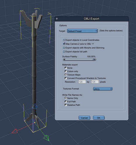

What do I check in pref. to export as object created in Carrara...I made this coat rack no textures and exported it as an object ...When I put it into Bryce it was a mass of a blob ....What am I not doing right?? Thanks in advance ....Trish

To export a model a OBJ should be as simple as choosing FILE / Export or,.. FILE / Save As ..then choose "Wavefront OBJ" from the drop-down file format list at the bottom.

If you have the OBJ, you could try loading that back into Carrara, and see what you get.
The reason you get a BLOB could be an import issue with Bryce, or a Modelling issue , such as smoothing / creased edges,.
or an option you've set in the Export from Carrara.
You shouldn't need to set anything differently in the OBJ export panel. but I know how having a bunch of options can make it more likely to click a few things to see what happens :)
There's a drop down option at the top, where you can select "Default" .. that should be good to go.
The "Export objects with morphs and skinning" only applies to objects with Bones, and "Does not export any morph targets"
It exports any "posed" model , in the current pose.
The Texture export options area will export the image maps you're using,.
or,. If you're using procedural shaders like Wood, or Fractal Noise,. there's an option to convert those into an image and export that.
Hope it helps :)
You are right about too many buttons....I reset like your screen shot and I am good to go now thank You.....Duh do I feel dumb..I appreciate the help. Have you seen an upgrade for Carrara 8 for sale all I can find listed is buying the whole program??? ....Thanks Trish
