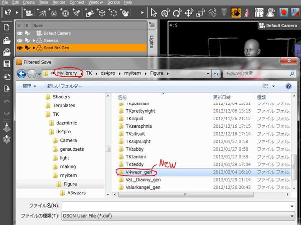

    marble, I show with actuall concrete case what Richard said,,
    1 Load genesis.duf ,(non character) then select genesis.
    load V4 clothing (I choose V4 Basic clothing,Sports Bra)
    2 auto-fit window may open. then V4 Basic Bra fit to genesis. (it seems not good fit but OK,, now for test
    and tell how to save it ^^; )

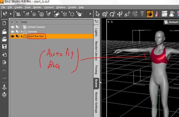

    3 after use "auto-fit" the old cothings auto rigged as triax figure.
    ( so you need not change triax figure again,,,, it has changed already. it is not clothing for V4
    of course if you hope,, you can change triax figure manually from V4 clothing,, but usually need not .)
    4 In scene,, I changed label name "Sport Bra gen" (click on labell name of figure in scene tab)

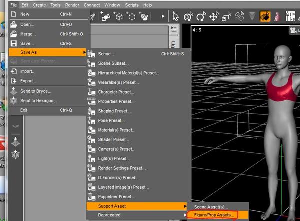

    5 then select it, go to top menu, File>save as>support assets>figure / prop assets
    6 the file exprorer window may open..
    first I need to decide, where save the "clothing.duf" which is link in content library, or Smart content to call actuall data.
    I changed default location ,,and I have made Figure folda which I saved,, so that I made new folda for V4 basic items
    under the FIgure folda. but you can save anywhere clothing.duf under your daz contents directory (may better not under "runtime")
    check my pic please.
    then I save the clothing.duf as SportsBra_gen.duf . I will see this duf file ,in content library. .

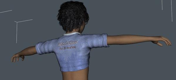

  • marblemarble Posts: 7,500
    edited February 2013
    EDITED ...
    Just discovered what I did wrong: I loaded the figure into the scene without having Genesis (Julie) selected. After which I went to the General Parameters and selected Fit To and selected Genesis.
    I then tried again by removing the item from the scene and re-loading it with Genesis (Julie) already selected.
    729 x 332 - 26K
