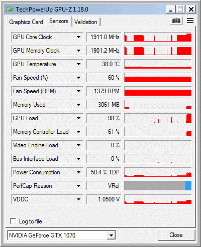

    I ran a simple test, I noticed the GPU doesn't go back to baseline between renders. That is a problem in itself, it shouldn't be holding vram like that. I took two cubes, added iray base surface, then plugged a simple 2048 gradient into the base color. Rendered, then closed studio to flush the vram. Opened the same scene and gave one of the cubes a different 2048 gradient in the base color and rendered.
    400 x 493 - 144K
    400 x 493 - 150K
    400 x 493 - 150K
    400 x 493 - 153K

    For the "After Render" screenshot, is this with all render windows closed? We know that, by design, Iray keeps the scene in memory if a render window is still open. By keeping the window open, you can start a new render in much less time, as the scene is already there.

    Sorry, yes, that is with render finished, and the popup closed. It seems to always be keeping around 2GB in VRAM according to GPU-Z after all those test renders until studio is closed, then it goes back down again.

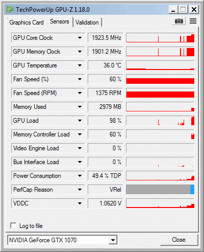

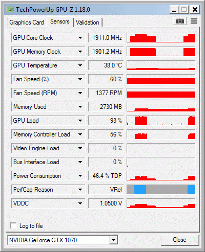

  • TheKDTheKD Posts: 2,711
    edited April 2017
    Padone said:
    @TheKD I don't get what are you measuring with your tests. You can't measure texture memory with gpu-z since it gives you the overall geometry + texture + iray workspace + framebuffer. If you want to check texture memory you have to use the log.
    The log doesn't appear to be accurate though.
    Test with two different NGS2 skins illustrates that the clearest. According to the log:
    Geometry memory consumption: 29.5474 MiB (device 0), 0 B (host)
    Texture memory consumption: 4.36719 GiB (device 0)
    Material measurement memory consumption: 0 B (GPU)
    Materials memory consumption: 125.996 KiB (GPU)
    Allocated 114.441 MiB for frame buffer
    Allocated 1.65625 GiB of work space (2048k active samples in 0.077s)
    Thats about 6.2 GB VRAM
    GPU-Z says the total vram loaded is only 2.979 gb total, less than just the texture load alone reported in the log.
    Ran the same test again, 2 g3f with different skins, both with NGS2. This time I set compression to 9999 on both to take compression out of the equation. Log says:
    Geometry memory consumption: 27.4106 MiB (device 0), 0 B (host)
    Texture memory consumption: 8.50781 GiB (device 0)
    Scene processed in 6.930s
    Allocated 1.65625 GiB of work space (2048k active samples in 0.000s)
    I used both afterburner and GPU-Z this time, to make sure GPU-Z wasn't just plain wrong, they are within 1mb of each other on their reading. So the log is really no good to go by it seems. Log says over 8 gb on textures alone, yet actual usage is way less. I don't really get it. image
    1208 x 704 - 440K
    1094 x 496 - 353K
    918 x 800 - 509K
    1046 x 796 - 573K
    1106 x 784 - 638K
    2000 x 556 - 370K
    2000 x 612 - 1M
    1254 x 542 - 519K
    Post edited by TheKD on

  • hphoenixhphoenix Posts: 1,335
    @TheKD Thank you for running all those tests!  They kind of bear out what was tested (though  not so thoroughly!) in the prior thread I mentioned.
    I think DS is 'accumulating' Geometry, Texture, etc, memory size AS it passes it through the CUDA interface to the nVidia card.  In other words, it's basing it's 'size' on the UNCOMPRESSED raw size in memory as it is loaded from file.  Which can be MUCH much larger than it's final size (we don't keep bitmaps or JPGs in memory in raw RGBA32 format.)  So it's accumulating those huge values, which are very innaccurate, and it's doing it for each and every file load (which may/may not be even utilized by Iray, depending on whether or not memory optimization is set) and before Iray gets it and compresses it (or not) based on the Compression settings.
    Which is why the DS Log file can report 9+ GB of texture memory used, then it renders on a single 6GB card without falling to CPU.
  • PadonePadone Posts: 4,315
    Did some tests, pretty much same results as TheKD .. now seems clear to me that the log is crap .. The good news are it seems it's the log that can't understand when textures are the same. While iray does understand it fine. The bad news are with this data I don't believe anymore that iray can use the shared memory. It was all bad data in the log.
      COMPRESSION ON    log    vram    ram
      1x G3F            350M   208M    1.4G
      4x G3F            1.4G   267M    1.9G
      Barefoot Dancer   1.4G   702M    4.9G
      COMPRESSION OFF   log    vram    ram
      1x G3F            2.5G   767M    2.9G
      4x G3F            9.9G   831M    3.5G
      Barefoot Dancer   FAIL   FAIL    6.4G  CPU REVERSING
    Now if the DS team could fix this bug please ..
