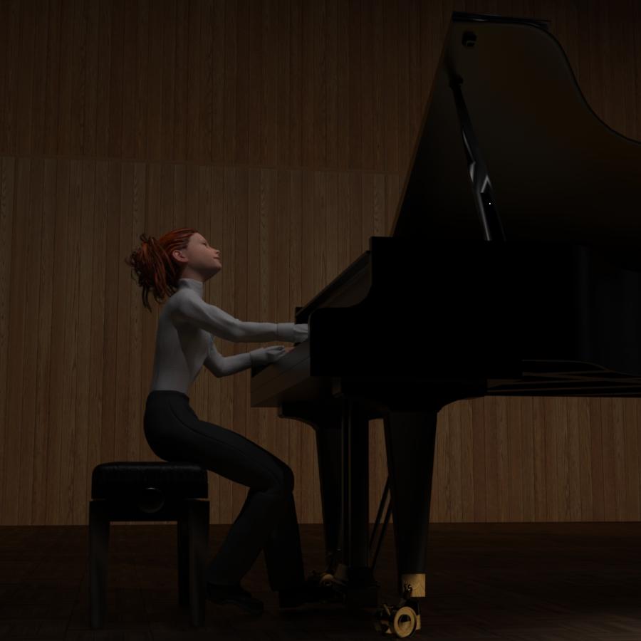

    After 7 hours and 50 min (6,465 iterations) this is what I got (the covergance rate was only 48%).

  • kyoto kidkyoto kid Posts: 42,481
    ...well adjusted the lighting angles and intensity a bit and let it cook overnight (total of 11142 iterations).  Her shirt still looks grainy but I thik it is because I forgot to adjust the tiling of the tecture to a smaller scale.

  • L'AdairL'Adair Posts: 9,479
    Looking good.
    I think the grain on the shirt could easily be mistaken for fabric texture. I wouldn't have thought it noise/grain if you hadn't said anything.
    edited April 2017
    ...againm it probably is because I forgot to adjust the tiling (used Mec4D's PBR shaders vol 2).
