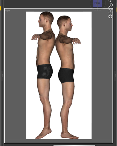

    No, he isn't zeroed...
    Zeroed on the left, as loads on the right. But what this shot doesn't show is the bounding box. The zeroed one fills the bounding box completely, while the 'as loads' doesn't. Matching the bottoms of the bounding boxes puts his head and shoulders at the correct height, but his feet are 'floating'.
    I think this is something similar to a problem I'm having rigging an item for K4. If I rig it in DS3, I can get it to fit and everything looks good, but when I open that in DS4.5 the item is 'off'....too low. If I rig it in DS4,5 and open in DS3, it's too high. I can't remember if I started with a zeroed K4 or not...
