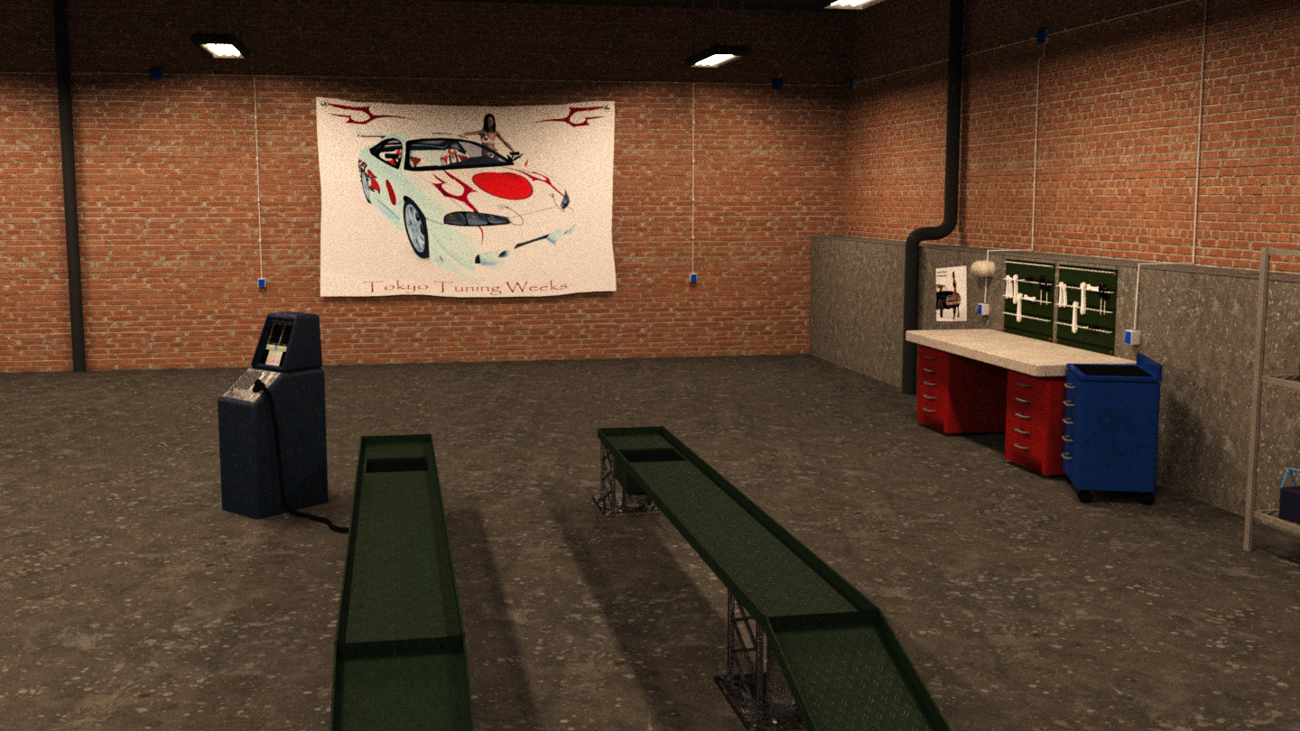

  • When using emissive lights I prefer the product Real Lights for DAZ Studio Iray particularly when operating in scene only mode.  I have read a lot of good things about the Ghost Light Kit as well but since I just purchased it I haven't had a chance to give it a try.  This scene is lit entirely by the Real Lights emissives and it renders fairly quick although I am stuck with CPU only in Iray so hard to say for sure.
    Tuning Garage
    Any grainyness is a result of me stopping it early since it is still a work in progress converting 3dl surfaces to Iray with Mec4D shaders.  All of the light fixtures have flourescent tube geometry with its own surface so I used an 85 watt flourescent preset on them.
