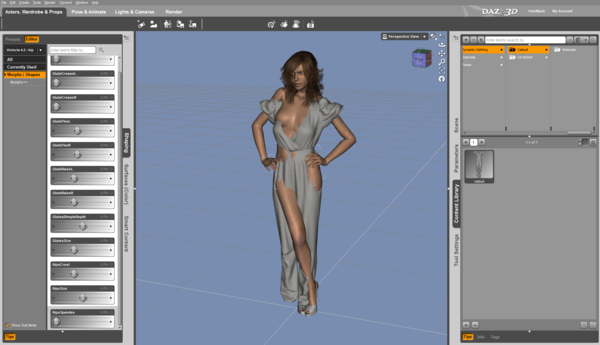

First time for me with dynamic wear, and I have to tell it, I'm totally lost ;-)
So, normally this wear should fit our famous Victoria4, could you learn me how to do that?
I crossfinger...
cheers ;-)
ps : yes it is sexy when the suit does not fit on her, but not ok for the job I have to do ;-)
802 x 967 - 339K
1912 x 1098 - 590K

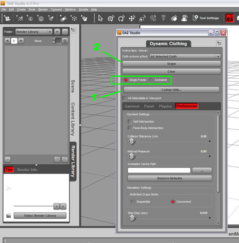

Hi, when you have loaded the clothing & have done the "fit to" V4; pose V4 and open the Dynamic Clothing tab (Window>Tabs>Dynamic Clothing). You will get a panel in like in the first image. Click the Preferences sub-tab and click on the collide with button. Generally you only need to have the clothing collide with the figure wearing it; but as Khory mentioned; you don't need to have the head selected.
You then click on the drape button to form the clothing around the figure.
In some cases; you need to do what is called an animated drape. I this case you load V4; load the clothing item and "Fit To" V4. You then open the timeline tab (Window>Tabs>Timeline); move the pointer (downward pointing arrow) to the 30 and pose V4.
Move the pointer back to 0 and open the Dynamic Clothing tab. In Preferences; select Animated and then set the collisions and press the Drape button.
V4 will then be shown slowly moving into the final pose with the clothing following her
