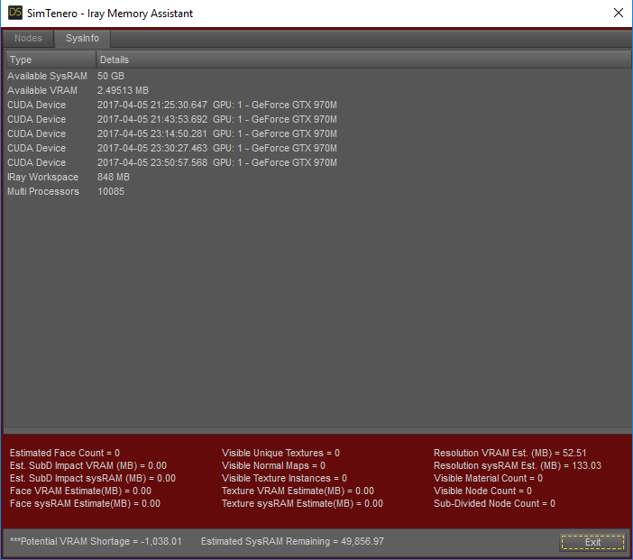

Hello everyone,
My render times in iRay have been extremely slow for some reason, even if there is only one figure in the scene my CPU usage will go to 100%. To help troubleshoot why the times are so slow, I used the "Iray Memory Assistant Tool" and looked at my specs. I was under the impression that I had a beastly good computer, but when I looked at the available VRAM I only have 2 MB of space! How is this possible?
My computer uses the NVIDIA GeForce GTX 970M card. According to GPU-Z, I should theoretically have 3 GB of VRAM, correct? I thought this was an excellent graphics card, why is there only 2 MB of VRAM available? Can someone explain why this is happening?

    It looks like it using around 0.5GB to drive your monitor/screen, leaving you less than 2.5GB to play with.
    Which is entirely normal!

    I'm really confused, the Iray Memory Assistant Tool" lists my available VRAM at 2.49513 MB. Does this mean I only have 2 MB of VRAM space? Also why would the bottom part of the tool be in red when nothing is in the scene? It even shows I have a potential VRAM shortage of 1038.01 which I'm guessing is in MB.

    The Iray Memory Assistant shows 2.4 GB. Your existing apps use 0.5 GB of Vram. Math is correct. The Memory Assistant has a bug in the sysinfo (should read GB not MB).

    For the folks that don't read all the thread: Iray Memory Assistant has a typo where it specifies MB instead of GB. It's not "failed due to illegal memory access".
    If you can't render a single character with a 1070, you really have some other problem going on.
