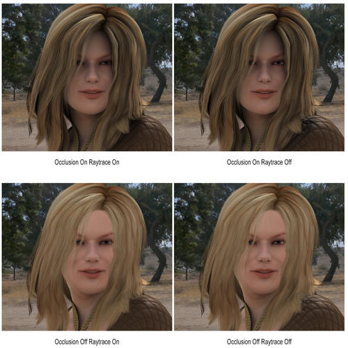

    Khory, thank you for this insight. I was able to create a test setup so I could try various settings and see the results. I can now see what removing occlusion does and what removing raytrace does. Occlusion seems to make the biggest difference in my scene, both in appearance and time reduction. I used UberEnvironment Occlusion with soft shadows and one distant light with raytraced shadows. I rendered 1676 by 1453 with Max Ray Trace Depth 2. I applied UberHair to the hair to be able to turn occlusion and raytrace off.
    Occlusion On, Raytrace On = 1 hours 19 minutes 29.87 seconds
    Occlusion On, Raytrace Off = 1 hours 5 minutes 35.46 seconds
    Occlusion Off, Raytrace On = 33 minutes 37.76 seconds
    Occlusion Off, Raytrace Off = 28 minutes 48.62 seconds
    2000 x 2000 - 1M
  • KhoryKhory Posts: 3,854
    I was just discussing this in a different thread earlier tonight. I think there are situations where the use of AO is more obvious. Renders that are "lighter" and on surfaces that are pale. It also depends on how the other shadows in the scene are falling. Sometimes it really shows, like your renders, and then there are times when I would swear on my life I can't see any difference it has made in the final render.
