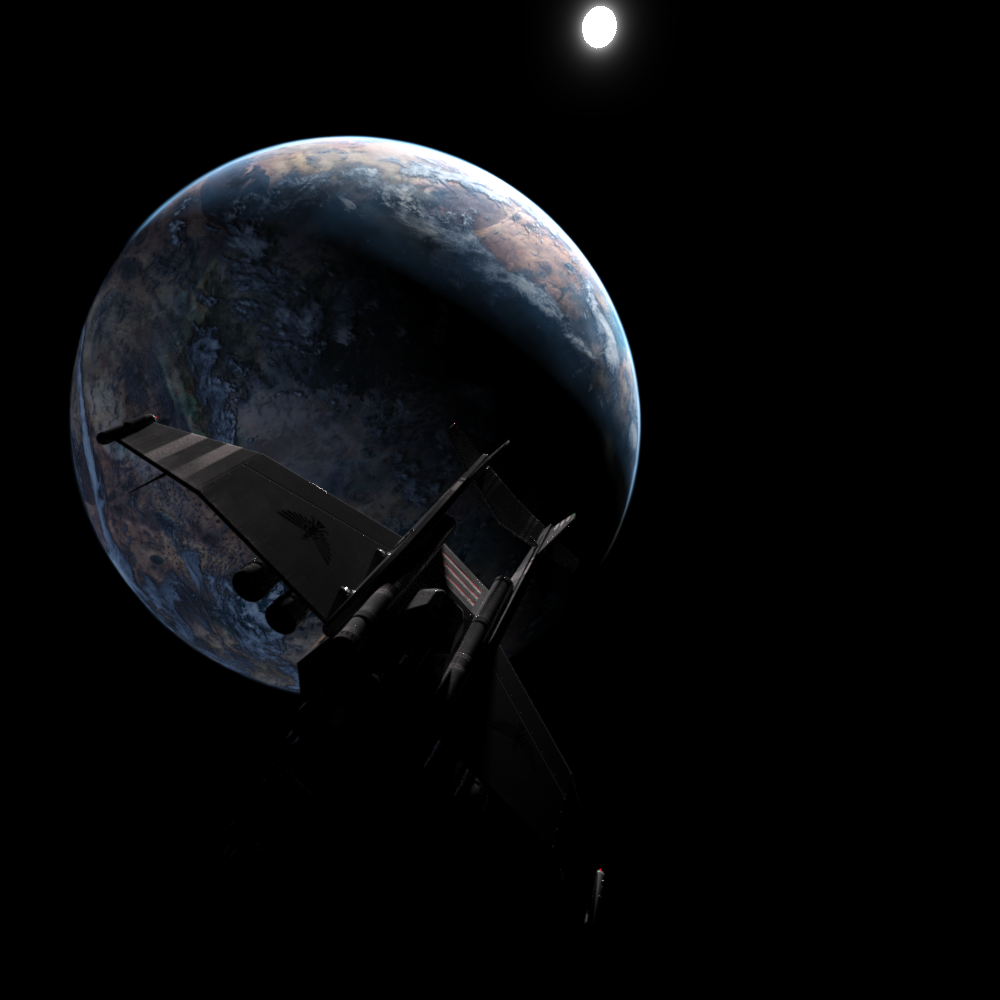

    The attached render has the Condor at x=0, y=0, z=-2000, but the planet is still "far away". 24mm Camera. Just loaded the 16K Earth. No other lighting.

    Thanks for the fast answer. My first try was an empty scene w/ default camera and the earth HDRI. Result was a black screen. Second try was the galaxy and I got that.
    I tried KA's recommendation for wide angle and prompted my question to you, so will go back to default focal length. I know some of my problems are just getting to know this product.
    I haven't touched the dome in my renders, just the camera. But my focal length was at the default. When I shorten the focal length to about 30 the planet moves 'further away'.
    Edit: Whadda ya know. Default focal length works like a charm.
    Great stuff! Looks like you've got the handle on it. I'm still monitoring the thread if you get stuck.
