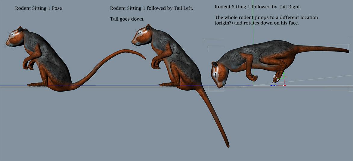

    New problem. I tried to use the tail poses with a sitting squirrel. The Tail Left pose actually made the tail go down into the ground. But worse was the Tail Right pose, which moved the squirrel away from the location that I had placed him in, and rotated him face down in the dirt.
    1173 x 538 - 207K
    Post edited by barbult on
    Is there any way that could be added to the product itself? I have no idea how to this. And it would be great to have one for the tail.
    I'd like to second this, both for the mouth open and for the tail. Installing the full set of Easypose dials really becomes a necessity once there are a couple dozen segments that need to be twisted and turned. I've done it manually before, with freebies that didn't have Easypose, and it's doable but a bit of a bother.
    I think what's happening here is the existing tail pose is being zeroed, and the tail is curling directly out of the screen. We can't see the curve because we're seeing the critter directly side-on.

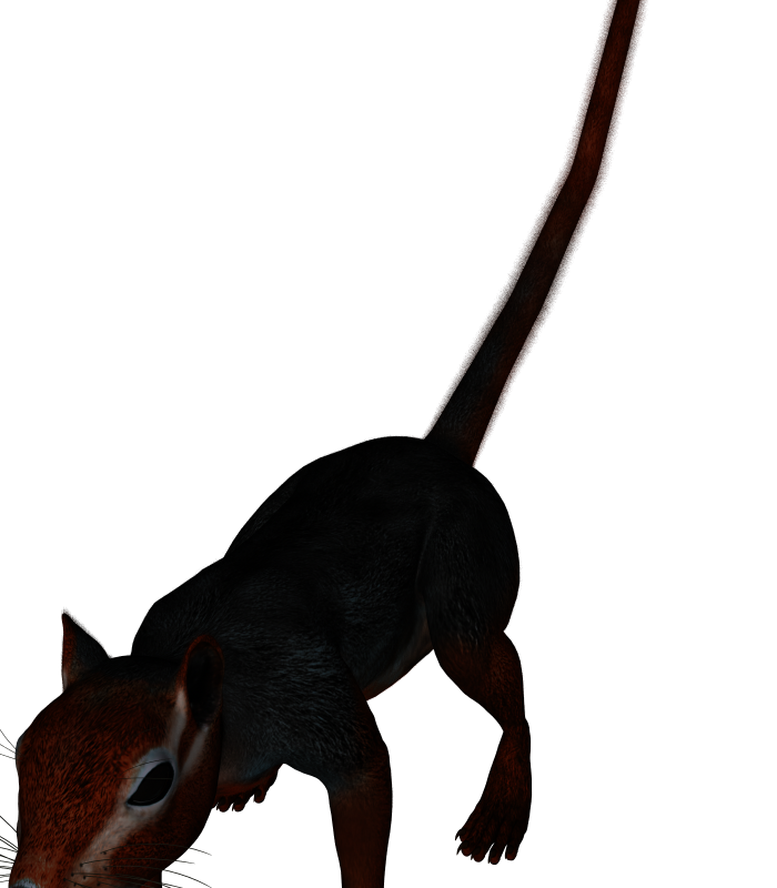

    Thanks, I will try it! In the meantime, I couldn't even get it to render correctly in 3Delight with the full version of LAMH installed... What am I doing wrong? Do you have to do special trickd in 3Delight too?

    In the product, you will see that, for each squirrel, there are two versions: one loads with the LAMH preset, the other doesn't (in 3delight, LAMH will look like green guides all over the figure). For the fur to render, you need to load the right actor. If that's not the issue, say so and we'll try something else.
    edited April 2017
    I tried first the default one that loads that has the green guides over it, then I tried adding the 3Delight material shader to the rodent, then I tried also adding the 3Delght shader to the LAMH group. All three renders came out the same, with no fur...
    Post edited by Wonderland on
    First af all, try resetting render settings: go to te Render Settings Pane, select the 3Delight render engine, click "Defaults" button.
    From the Content Library, load one of the squirrels from the Rodents by AM->Breeds->Squirrels->3DL LAMH folder; the squirrel with the green guides over it should appear in the viewport
    Click render
    These are the steps to produce a minimal 3Delight render. If it works later on you can build your scene, pose the model and add lights. Or convert to Iray and render with its engine.
    edited April 2017
    Click render
    That's exactly what I did the first time... I didn't even bother to pose it or light it, I was trying to see if I could get the fur to render. I couldn't in IRay or 3Delight. I reloaded the squirrel for 3Delight and just did tests for the fur. Could not get it to work.
  • UthgardUthgard Posts: 902
    That's strange. There seems to be some fuzziness around the tail, did you try scaling up the figure? If so, you need to lenghten the hair in the LAMH tab. If not, try it just by loading the figure with the guides but without reapplying the materials (it already loads with 3delight presets). The problem could be caused by applying materials to the guides, so this is the most likely suspect.
    I didn't add material to the guides until the third test. Yes I did scale up the rodent but the guides seemed to follow. Do I need to scale that separately?
  • I didn't add material to the guides until the third test. Yes I did scale up the rodent but the guides seemed to follow. Do I need to scale that separately?
    No, the guides should follow automatically. Can you just try the standard routine, so that I can see what result you get? Maybe send me a screenshot of both the viewport and render result?
    edited April 2017
    It's after 2:00AM here so I'm actually about to go to sleep but here was my result of the plain 3Delight render. I didn't pose it except for moving the tale up a bit or light it or even frame it, it was just meant to be a quick 3Delight test because I couldn't get the IRay version to work yesterday... Before it rendered, it looked just like this with green dots overlaid on top of it. I'm already in bed with my iPad so can't do a screenshot right now... Oh and this one was supposed to be the fluffy tailed one.
  • Ok, send me an update as you will try again. Cheers.
    OK thanks smiley
  • Just submitted an update with fixes for the Tail Left and Right poses, and four pose controllers to open the mouth, bend tail up/down, left/right and shape it to S. Will be there as DAZ updates DIM and installers.

  • I noticed that there is a new update for this product which fixes the tail issue that people were experiencing.  I have downloaded it and when I went to install it through the DIM it tells me that the install failed.  Has anybody else had this issue and if so... does anybody know what the fix is?
    Thanks.
  • Charlie JudgeCharlie Judge Posts: 13,659
    edited April 2017
    Thanks.
    Yes. That upate failed and also three other updates failed to install.
    Post edited by Charlie Judge on
  • Alessandro MastronardiAlessandro Mastronardi Posts: 2,659
    edited April 2017
    Try to uninstall it, delete the package, and reinstall it again (all these operations can be done within the DIM). If it still doesn't work open a support ticket, unfortunately there is nothing I can do for DIM issues.
    Post edited by Alessandro Mastronardi on
  • SimonJMSimonJM Posts: 6,102
    Just downloaded and installed it via DIM, and all was fine.  Loaded it up in DS and the Pose Controls for tail (Left-Rigth, SHape S, and Up-Down) amd Mouth Open seem to wrok fine.
    DIM installation of the rodent polymorph update is now working for me also.
