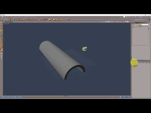

Hi, I have a workaround but currently looking for some advice for better out of box solution.
Bend Modifier and Deformers are working fine along Y and Z but whenever I try to
Bend on X-Axis I am getting 8 Shape. I remember it worked fine in the past.
There are multiple ways to Bend but I am wondering what am I doing wrong here with Bend Deformer?
Thanks in advance!

  • Samuel S.Samuel S. Posts: 329
    Never Mind following solution worked for me. I will also try this in Vertex Room. Normally I try Modifiers in Assembly room and then in Vertex Room.
    1920 x 1040 - 280K
    Here is another side of wall and minor tweak in modifier Settings.
    1918 x 1042 - 357K
    Adding Quick Render.
    2048 x 1004 - 1M
    Here are settings under Bend and Twist Modifier:
    Twise Angle      = 00
    Bend Angle        = 90
    Bend Axis Angle = 270
    Limits   = 28-100
    Axis = Y
    In   = X,Y,Z (all checked)
    Flip = Along Major Axis checked
    I think it is fine  to try out in Assembly Room first before trying them in the Vertex Modeler Room. I will also add a video in near future.
    edited October 2018
    You are welcome; video showing bend deformer is also available here:
