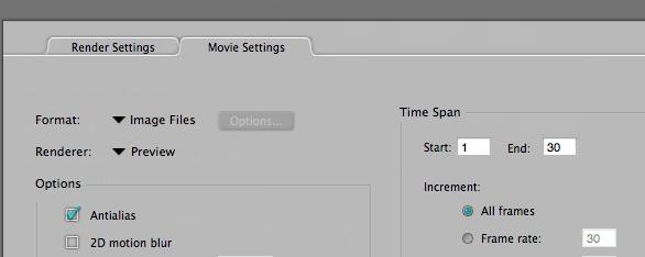

    In Poser, I make the ground invisible and then export image files from movie export option. This will give you a png sequence with alpha background and your animation without need to key or mask. Not sure about Daz Studio. (see screenshots)
    282 x 166 - 21K
    282 x 166 - 22K
    586 x 234 - 26K
