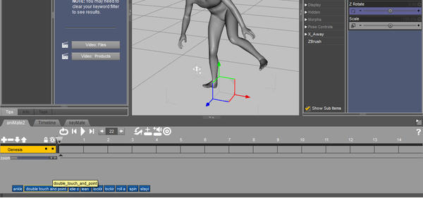

In the image below, you can see that I have some aniblocks below the time line. When I hover my mouse pointer over them, the Genesis figure in the viewport starts animating. It will keep animating until I move my mouse pointer off of that aniblock. Does yours do that?
If not, then, it probably wont play when you drag it to the timeline either. There must be something strange going on here. I have a slightly older version than you for the moment, 4.5.1.6, but it alwayas worked that way, even in DS3.

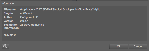

aniMate2 came with DAZ Studio 4. I didn't install it separately. I'm attaching a Mac info pane and a snap of the plugins footer for aniMate2. The version seems to be v2.0.4.1

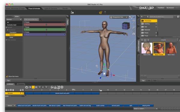

Here's a screenshot too, showing the timeline in play mode with a dancing aniBlock from aniMate2, yet the figure is completely still.
