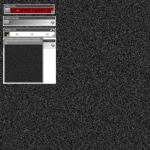

    In DAZStudio you can make a grayscale map of flakes (simple noise might do it) and use it in on the Ambient -- there are a couple of Supersuit shaders that use that effect. I'm not at home to give details though, and I don't know how that's done in Poser.

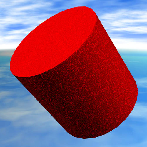

    Poser doesn't have Ambient controls?
    See the second pic below -- is this something like what you're going for? I threw some Hurl Noise on a 1024x1024 jpg in GIMP and used it for an Ambient map on 100% white. The supersuit sparkle-shaders I mentioned earlier get a subtler effect by doing the same on the Specular controls instead and tiling.
