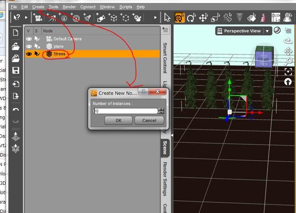

    if you hope tree as gropu you can do that.
    996 x 567 - 120K

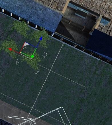

    When I used Nod inhstances; I got my 50 trees but for some reason I do not understand I did not get the scaling of the tree I used which is some 50% smaller than the original of my addon I used to get it. I can't see the reason and that's my problem . Once the scale is ok I keep all the way until I have place the rees where they should be.

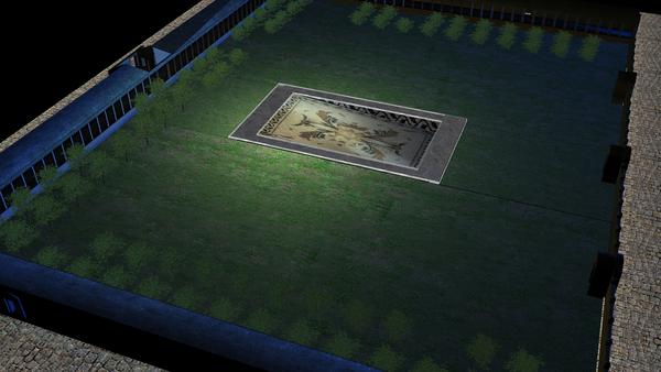

    Here is an example of the way the trees should be planted: The little circles are the tress ; they should be all identical in shape, height and
    orientation. My model is scale 44% of the original; when I do the option I get 100%!!! Why?

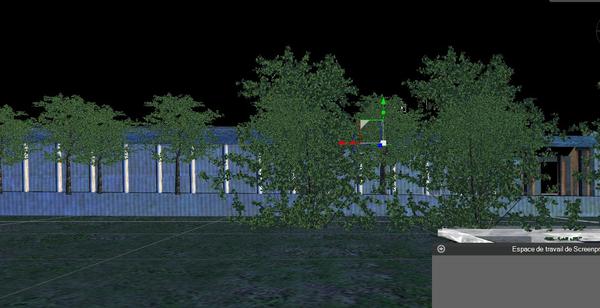

    Hi , sorry to answer so late, but I was at the Paris opera yesterday evening and returned very late.
    I've again made a test and as you can see it is not ok. Let me explain in details what I did:
    I bought at Renderosity the addon "Urban Trees".
    The original name of the tree I chose is "dfUrbanTree02"
    After scaling it and positioning it at the right place I created a subset of the new element at the right size with
    the French name for the tree "Platane".
    I selected on the scene this element and used the "New node instances" create option and asked for 3 trees.
    The program created 3 trees with the name Platane with their number beside the name (1, 2 3)
    Now as you obviously can see on the picture under, the size has returned to the original size of the tree as it is
    in the addon.
    I have to create in all 50 trees. If I get this result non only will I have to position 50 times
    the trees in their right place, which I can't escape to do of course, but I'll have to rescale each of the new
    50 trees which is a bore as it forces me to change 50 times the 9 coordinates of the trees.
    There must be a way to have a simple copy of my subset with all its correct dimensions and as we can see
    Node Instances options do not solve the problem or else something is missing in the way I use this process .

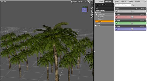

  • LindseyLindsey Posts: 2,017
    edited January 2013

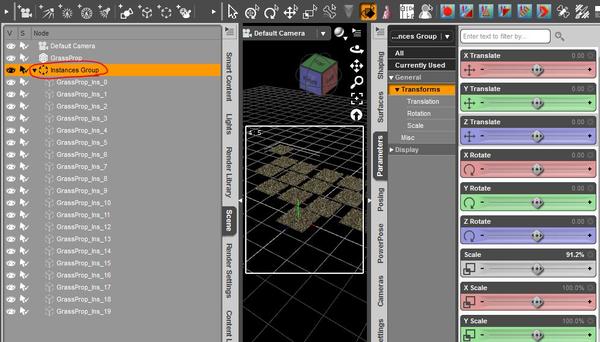

    Just go into the Scene Tab and select the "Instances Group" you created, then to into the Parameter Tab and change the scale to 44%. All the trees will be scaled to 44%. Not the "big" tree in the second pic is the original tree which has not be scaled to 44% yet.
    1341 x 740 - 127K
    1335 x 739 - 145K
    Post edited by Lindsey on

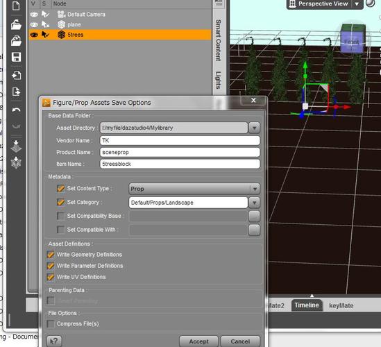

    I save it as new tree block. I think you better save it as figure or prop first. it make actuall data ob the object.
    and if you save it as new prop (5trees block)

    1068 x 623 - 115K

    Thanks, of course it makes sens, I did not think of that!!!! I new I had something missing in the process. many thanks Lindsay. Now my on ly concerns will be to position and set the intervals between the damn trees! Arecheologists are too clever, they found the remaining burnt roots of the trees in excavating the site! Could not they think to the poor 3D developer before doing so! lol!
    Oh that's the easy part.
    1. Say you're working on the back two rows.. left to right
    2. Just place the first tree in the first row on the left and copy it's Translation group (the x,y,z settings) in the parameter tab.
    3. Select the second tree and paste the Translation group settings you copied. It will move the tree right on top of the first tree
    4. For the second tree, manually type in a new Translation X value and it will move the tree to the right (or you can drag it).
    5. When you are happy with the spacing, note the number difference.
    You can copy the second tree Translation values to the third tree and modify the X value by the increment distance, and so on and so on.
    If I was doing this, I would calculate the new X value for each tree in a spreadsheet using a formula and you can just hard code the Z and Y values as they will be the same for each tree in the row and just change the X value calculated from the spreadsheet to precisely space them from left to right.
    The next row from the back row will have the same y and X values as the back row, but you would change all of the Z values (to the same value) to move the row in front of the back row. Hope this makes sense to you.
  • edited December 1969
    It's ok, I've done it! I discovered at the same time that the guy on sketchup who drew the Palestra did not respect the real proportions so I had
    to add a few trees , but it's not a problem. Now I'm on to set the Amphitheater which is besides the Palestra on the side of the slim wall. Here again with my photographs and guides I can see that the same guy did a rather approximate job; there is no hill between both monuments; I hope Bryce will help me solving the problem, sinking the amphitheater like the Titanic is not exactly my cup of tea.
    Thanks for all the good ideas I keep in mind for other similar problems.Here is the finished plantation of the trees! Remains to see the lighting but i'll do that once the whole scene is finished and my figure positioned in one of the corridors
    2000 x 1125 - 2M
