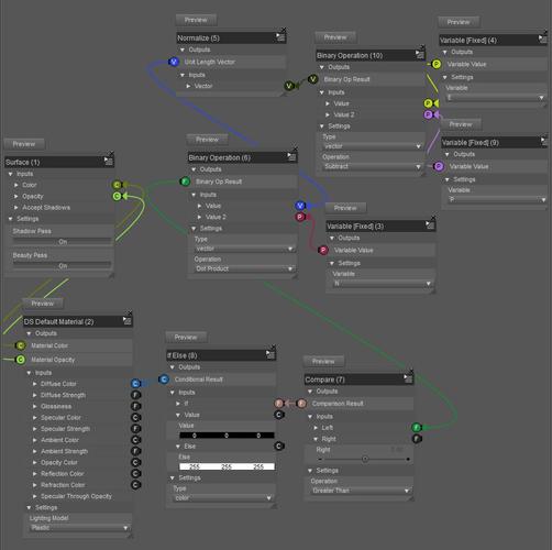

  • Richard HaseltineRichard Haseltine Posts: 111,875
    This is a simple shader that makes a surface black if its normal points towards the camera, and white if away. I think it will come a cropper if it's reflected - I couldn't find the information I needed to be sure, but possibly using I instead of the little nest that subtracts the surface position P from the eye position E and normalises the result would work better (that is, replace bricks 4, 9 and 10 with a single Variable brick set to I). In practice, you'd probably set up two distinct materials and use the If brick to control which went to the output bricks.
