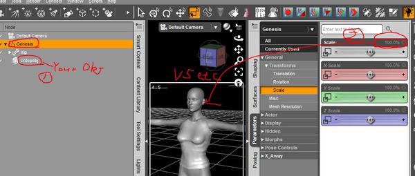

  • kitakoredazkitakoredaz Posts: 3,526
    It is simply scale problem , when use transfer utility,
    you need target obj( your suit) fit to 100 % scale genesis.
    the figure seems be applied already victoria 5, or etc
    it may change genesis size to 95% by ERC, when apply victoria 5 morph.
    I say again,, You need to make obj which can fit 100% size genesis.
    if I were you , load your obj (you made) then parented genesis (with the vicotria5 shape)
    then select genesis, go to parameter tab >Transform>scale change 100 %.
    it can resize your obj (suit) can fit to normal genesis size.
    then ,,, unparent the obj,, export obj (name as suit_100 etc)
    in daz stuidio, load genesis apply morph (vicotria5 ) then change size 100 % as same as above.

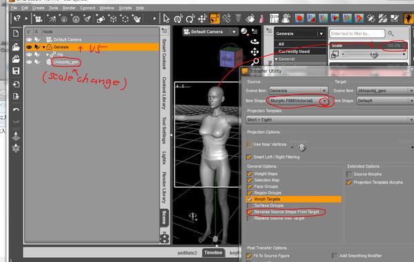

    import the resize obj (suit0100)
    then use transfer utility with reverse option. it must work.
    save it as figure or prop, then load V5 in ds, load the clothing,,
    it must fit V5 and V5 morph scale!!! or other shape of genesis morph
    V4 for genesis, V5 super model,, etc,, and size.
    you may feel happy OK!?

  • edited January 2013
    yeah now i got it. I was using default shape option Hence was unable to click reverse option
    Thanks for the detail pics
