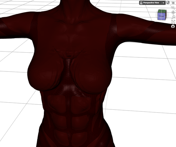

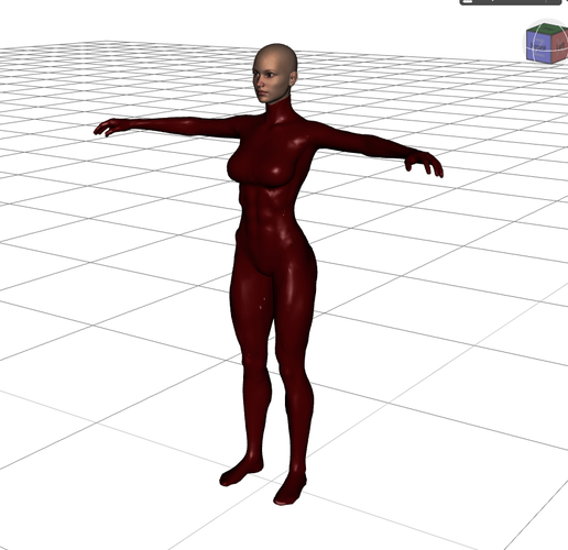

Very new to Daz 3d, started yesterday and I'm already working away on my first model, I've encountered a problem, when I select 'fit to' to bind the suit to the body, the suit deforms, am I missing something, how do I fix this.
I modelled the suit in Zbrush, so I've transferred all the morphs etc, so the suit deforms properly when moved, I just need to bind it to the body. Helppppppp!!!

  • simon_2213780simon_2213780 Posts: 0
    Also, I have tried the smoothing modifier thing, and the collision settings, but it doesnt seem to work for this suit.

    Yes I am using transfer utility, here is what I done>
    1- IMported the suit into Daz as an obj.
    2- Converted the suit to subd.
    3- Used transfer utility to transfer, weight maps, selection maps, face group, and region groups ( i select Genesis as source and suit as Trget) I also keep 'Fit to' checked
    4- And this is where it goes wrong, the morphs etc are all transferred which is great, but the suit does not keep it's original shape, I've done the same few steps above so many times, checking and unchecking different boxes, to see what helps.
    The closest I have gotten is, if i leave 'Fit to' unselected i still transfer all the attributes of the Genesis mesh to the suit, but obviously the suit and Genesis are not bound. If I right click on the suit and select 'fit to' I get much better results, but it still does not conform properly.
    So frustrating!!! Luckily i'm bald so I won't be pulling out my hair.

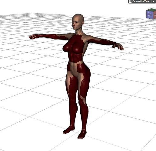

  • Richard HaseltineRichard Haseltine Posts: 111,875
    Since you have modelled the suit around a morphed Genesis you need to tell the Transfer utility to reverse that. Set the Source shape to Current, and in the extended options check reverse Source shape from target. If possible it's best to model around the zero shape of genesis, not a morph.

    Oh great thanks guys the results are definitely much better, AMAZING!!
    One last thing, now that i've done that, it seems to have deleted a piece of my suit, I'm guessing because it is trying to fit to the morph right, Is there a way around this?

    Richard beat me to it...
    Umm...that 'stretching'/'scrunching' around the breasts...the only real fix is to take the back into a modeller and fix it.
    Export the suit, as is. Export the morphed character. Import both into your modeller. Fix. Export suit as an obj. Then using Morph Loader import the fixed suit as a morph for the suit. (I can't find it right now, but there's a thread with pics showing the exact process for this...)..

    It was the Genesis model, although after importing the suit back into Daz from Zbrush, i had to eyeball it and resize, as It came in wwaayyyyyy smaller than the size I exported it at.
