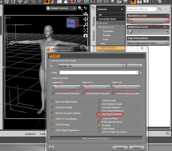

    1. this time I challenge "Rilley Head morph" by blender shape key.
    load genesis set Resolution level base, or subdivision level zero.
    (must need you know when make morph)
    then export(save) it as genesis_zero.obj in your work floda.
    (if someone need setting,,I stick the pic to check it easy. there seems many setting,
    but I do not care, it work for me good.
    keep the genesis loading, then apply rilley.duf character preset.
    (If it product has Head morph? I do not know,,)
    Rilley morph (or stephanie) change scale , so must need adjust scale 100% manually.
    and set set Resolution level " base", or subdivision level zero.
    then export the Rilley shape genesis (100%scale) I named it "FBMRilley.obj"

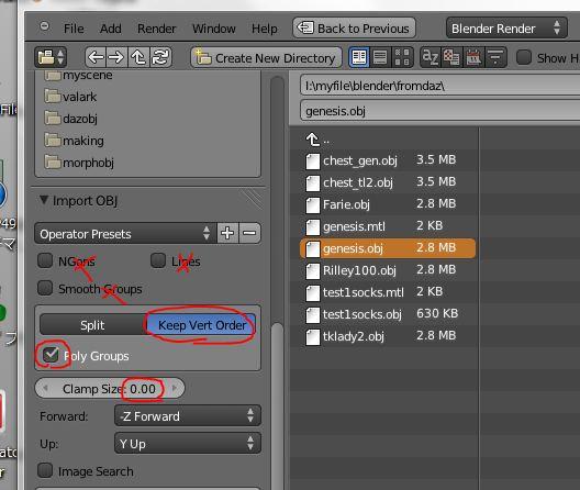

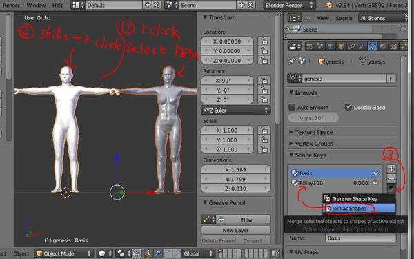

    2 improt genesis_zero.obj (check pic if need setting)

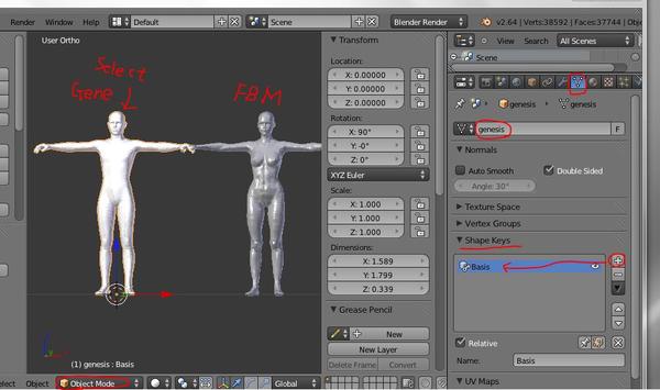

    in object mode, select genesis_obj then go to right side property editor pane.
    click object data icon. top of property editor,
    you may find "shape key" section.
    simply click "+" it auto add "base" key. it is base shape(zero shape)
    3 click A key to deselect genesis, then import Riley_100scale .obj to the scene.
    now genesis cross with Rilley shape, so just drug Rilley to right or left side to see clear.
    I set Rilley_100 scale shape as genesis new shape key.
    Select Rilley_100 by R-click, then, shift+R-click genesis.
    then click reverse triangle (under "-" icon) then select," join as shape"
    there is new shape key "Rilley" for genesis.
    you can change name of the key,, may set "FBMRilley_100" etc.

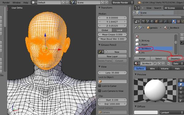

    6 need to select vertices where you want to translfer from Rilleyshape.
    on this case, I said, make face,, so select face.
    (there is many way,, but I simply use "B" and select vertices rectangle by which I hope.
    then I change property to material in property pane,
    select "Skineck" first, then deselect ".Skinneck" you may need not,,Blender simply can copy the vertices,
    not need reimport or import or make stop over morph (as Hexagon need)
    but I hope not to change Skinneck area. and it may select symmetly vertexes so I did.

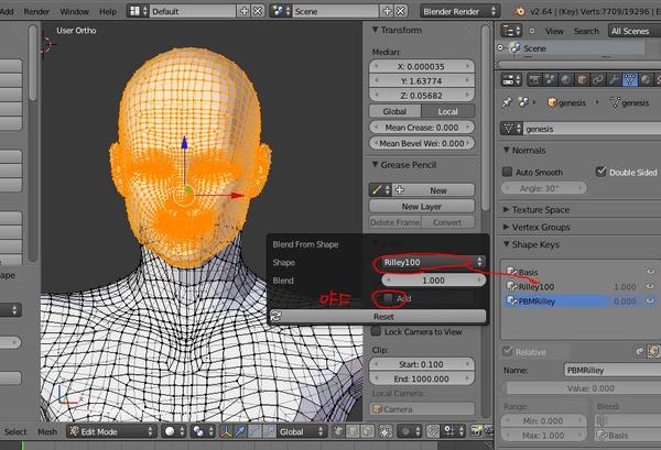

    Take care,, "you never select Rilley shape head vertices. You need to select vertices on the "PBMRilleyface" key
    I will copy and paste Rilley key current vertices. so now you must select genesis zero shape head vertices.
    on "PBMRilleyface" key.
    7 with keep selection of vertices,,use short cut "W" then select Blend from shape.
    if you do not like short cut,,
    go to 3d view header (but default it locate under the 3d view ^^; blender header,, I call)
    mesh>vertices>Blend from shape..
    then small window must open.
    you need to select the key which you want to translfer,
    of course we need "FBMRilley" key, and value "1.00"
    congratulation. you translfer Rilley head vertices to the new key.
    so if you select the new key, genesis head only change to Rilley

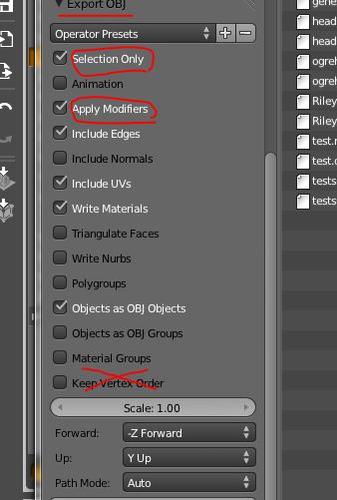

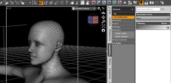

    8 lets exprot the obj to daz studio by morph loader.
    so first change mode to object mode. by "tab"
    then must select "PHMRilley" key , export it as obj.
    if you need , see my setting. if you set wrong often cause problem, when you make morph.

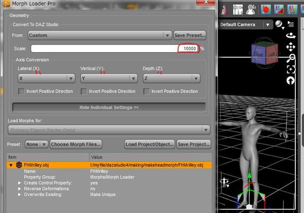

    may need change morph loader pro setting. just change scale =10000%, (exprot 1% from daz, so import 10000%)
    it works for me.
