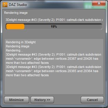

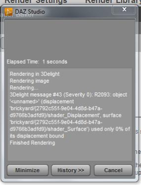

    A few other issues with Bot Genesis, (using the textures that come with the product) during Render there is a Error message but the render still comes out fine
    Another issue is that the V5 Genitals do not work correctly with the Bot Genesis, it shows problems on the models, and it displays errors during rendering, however the renders still come out fine
    added 2 error message images, one without the genitals during a render and one with the genitals during a render, dont know if these are anything to worry about or not, as I said the images still come out fine without errors on the renders that I can see

    As for the error messages, I wouldn't worry too much. That error is the subdivision trying to deal with an unusual face in the figure (as it explains, there are at least two attached faces between adjacent vertices), and any impact on the final render should be minimal, if noticeable at all. If it did this a lot (we're talking 20+ times) then it might be a bit more visible on the model, so you might want to keep an eye out for any glitches in the image.

    Thanks, didnt think it was anything to worry about much and is not noticeable on the final image

    The first error is normal, chances are there's a transmap in the displacement channel of the eyelash surface, 3Delight doesn't like black based maps in displacement, especially when there's Opacity and reflections involved when it's creating a shadow with that surface.
    The second is more serious, severity 2 & 3 warnings are 3Delights way of saying "there is something really wrong here and I don't like it", best to bug report it, that way DAZ & the vendor can get together and fix the issue.

    I was getting the same or at least a similar error message to the second one when I was rendering the Genesis Bot, I wasn't using the Genitals, I just thought it was something I had done as I'd been messing around alot with textures and shaders.
    I had alot of the error messages and the renders were coming out with the human skin area looking very black and sooty. I just cleared the scene and started again.

    Wrong displacement map or an unnecessary one are probably the most common cause...and can have an impact, but not on the rendered image, but rather the render time. Especially with raytraced shadows as it will do the calculations to create the shadows...and since black, in 3DL is 'all the way down' (white being 'all the way up'...medium grey being zero), it's calculating a lot more than needed.
