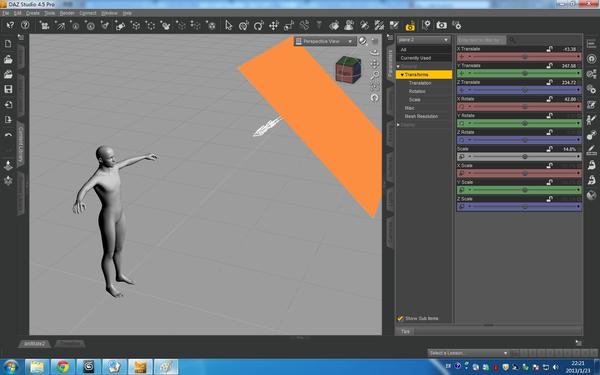

I craet a plane which i put it behind a light
But unexpectedly its block me lighting

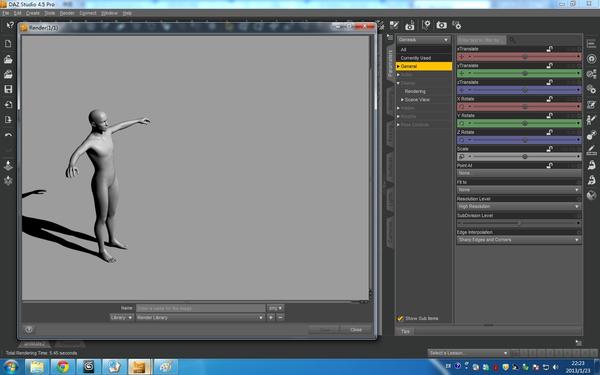

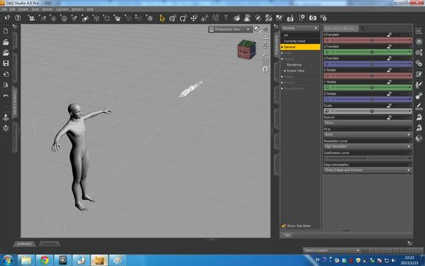

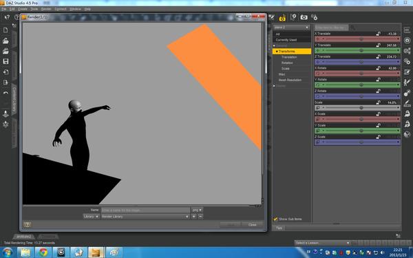

image1 is a plane behind a light
image2 is the render
image3 is i delete the plane

what is this problem how can i fix them?

    that looks like a distant light, they work like the Sun does. for this type of light the Object for it is not the point of origin of the light, but just to show what direction the light is coming from.

    That is correct.
    As Rareth syas, the arrows only indicate the direction that the light is coming from, but it is supposed to imitate the Sun, and it is millions of miles away, so it doesn't matter where you place it in the scene, just the direction of the arrows matters.
    What you are doing would work with a Spot or Point light, but NOT with a Distant Light.

    But to answer the question. If you don't want the plane to be seen by the light and cast shadows, select it in the scene tab and then in the parameters tab turn "Cast Shadows" off - now the light will pass through it.

    So the plane you have in the scene is an UberArea Light? If that is the case you can make it invisible by setting the opacity to 0% in the surface tab for the area light. It will still cast light but it won't block out your distant light.
