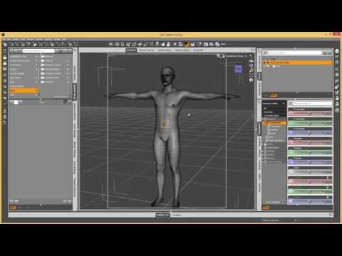

    To have the mesh AutoHide the item needs to be a geoGraft - and you need to make sure that the ring of vertices around the ouside of the attachment is the same as the ring of vertices around the hole it is going to create, so that they can be welded together.

    hmm ok, is there an example video or tutorial to help show the steps involved. Though it might help that I extracted some of the plains around the location when making the item so it should have the correct ring it needs, though i wish i could remember how to add vertices to the planes so i can improve the item in question
