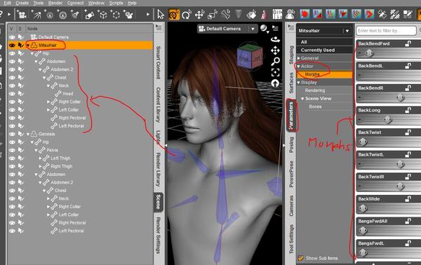

my picture, is mitu hair for genesis. now it fit to genesis.
then the blue bones are, rigs of hari. you can see these bones are "fit to" genesis rig positon.
And,, this hair has not ghost bones , so I can not move these rigs when fit to genesis.
but there are many morphs for adjustment. (I love hair which has ghost bones,, )
in Actor>morhp section. so I can use them ^^
