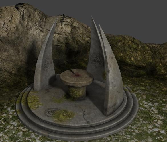

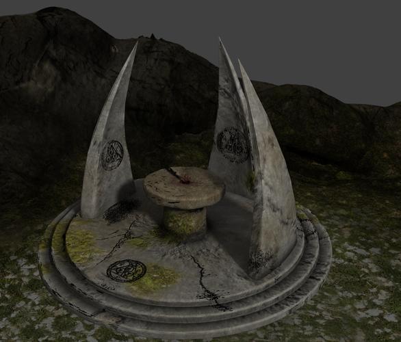

  • BejaymacBejaymac Posts: 2,000
    I got my friend to do a couple of quick renders for me, the first is the settings I set up, that's bump and displacement, the second has had the bump & displacement removed and the normal maps added.
