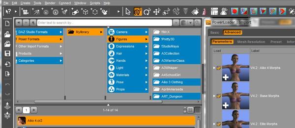

    open content library tab from top menu,
    then poser format>Your content folda for poser>Figures>DAZ people.
    there should be Aiko4.cr2 if you have installed AIko4 correctly.
    can you see other cr2 files ? (eg victoria4.cr2 )
    and can you stick your pic of Content library ? it may help you to find what is wrong.
    987 x 429 - 82K
