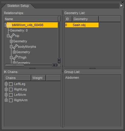

    An addendum: I looked for Figure Setup Tools as you mentioned but don't see them anywhere in my DAZ plugins.
    Post edited by tdfotw_fb5b5c81f2 on
    Do you have View > Tabs > Skeleton Setup in your version of DS3? What does it say when you look at Help > About DAZ Studio, mine says 3.1.2.32 Advanced Edition?
    You should colour the V4 mesh, so that you can clearly see the different polygon selections for each bone. I can't find an image at the moment. The idea is to split your clothing mesh to be as close to the V4 mesh as possible.
    DS3 has Morph Follower, which will put the morphs from the base figure into the clothing item for you, and then you have to save it.
    Here is what a mannequin for V3 looks like with the bone areas coloured, it helps a lot when creating groups in your clothing.
    688 x 716 - 233K
