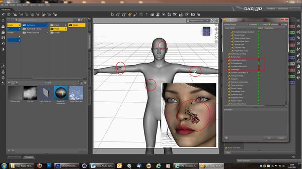

Hello,
I've some problems with the latest DAZ Studio Update. Since my last update DAZ Studio 64-bit (version 4.5.1.56) and the files Genesis Starter Essentials (version 1.11_trx) and 3DBridge (version 1.2.1.56), Decimator (version 1.3.1.56) and GoZ (version 1.2.1.56) I have problems with the view of DAZ Studio and plugins.
Although I have also installed Reality 2.5 for DAZ 64 and Lux Render Open GL for 64-bit new to me this plugin is in the DAZ given update as "Failed", you also have other 2 mentioned plugins listed as "failed", which I do not can match.
Additionally me Genesis is displayed with broken polys.
Also, can I save DAZ scenes just as DSON user files and no longer as pure DAZ files. Is this been changed in general?
This is all just since the above update.
I have already tried to reset the database and DAZ Studio to completely reinstall, but that has brought no success. How can I fix this? Perhaps somebody can help?

    Ok...first, the poly issue...what video card do you have?

    Looking at the pic, I thought you had a Quadro, it's a known issue and very driver dependent.
    Update the drivers...the latest version should fix the broken polys.

    Hello mjc1016, that was the reason for the broken polys. I've taken the newest driver (from 05.01.2013) and now it is all ok with the Genesis. Thank you!
    The next point of the plugins: I've also new installed Reality 2.5 (I think FreeImage is a part of Reality) but this plugin is shown as failed. And what is with the other plugins which are failed?
