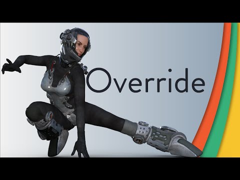

    In this how to video they say at 2:36 that the aniMate team is working on it. That was several months ago. Might be something in this video that will help with your problem though.
    Are you baking the keyframes? If you're not, that may be the issue. Might be something helpful in this video and the others on how to use aniMate.
    Thank you very much for the information Kevin.

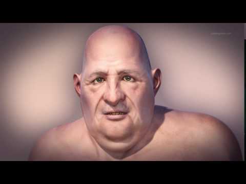

    The videos were very helpful.  It's great to know that they are woking on Genesis 3 support.  I was able to use some of the tips to get everything working.
    Below is a quick update of my first experiment.  In this version I was able to make an aniblock of the motion capture from Brekel Kinect Pro Face and overlay an aniblock made from Mimic Live.  The next step is to add more aniblocks to smooth things out.
