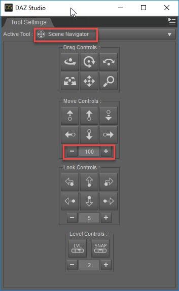

  • TaozTaoz Posts: 10,344
    edited March 2017
    If there is another object close to there you want the first object you can select and copy-paste the XYZ Translate values (select and copy all three at once) from the second object and paste them to the first, then it will move to where the second object is. Easy to put people in a car that way, for example, you just copy the car position to each of them.
    Also, to move the scene fast, use the Scene Navigator on the Tool Settings pane, here you can adjust the speed of the controls.
