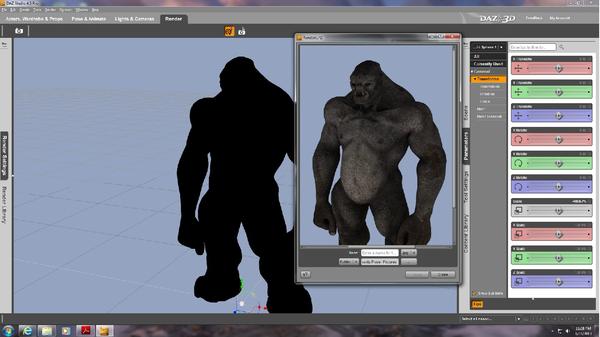

i tried to set the uber area lighting
but some problem just appear
my people just be black!
what is the problem
can just anyone help me plz!

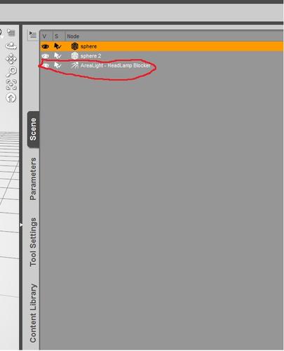

  • edited December 1969

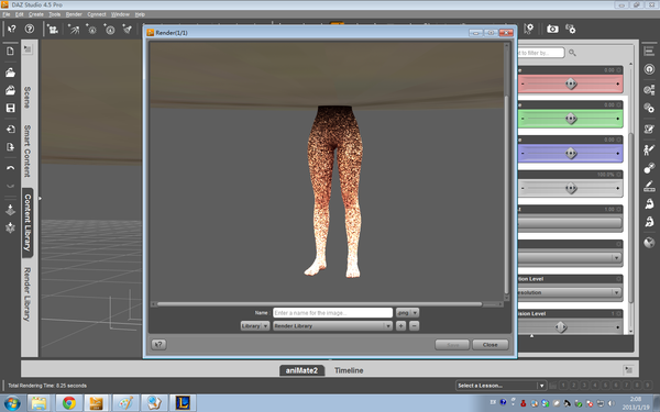

    i let my figure's legs out of the sphere
    then its got light!
    i cant just let the sphere inside out
    i already set the scale -100
    but its not working
    how can i do
    1440 x 900 - 316K
    it meaning the inside of this sphere is not lighting
    but i exactly set the scale -100

  • SzarkSzark Posts: 10,634
    Can you show the Scaling Parameters of the sphere which is in the Parameters Pane when the Sphere is selected.
    If you set the Scale slider to -100 then it should be inside out. If it is scaled to -100 then make it a positive value and test that.
    DONT USE PRGRESSIVE RENDING as there are still bugs with using that feature.

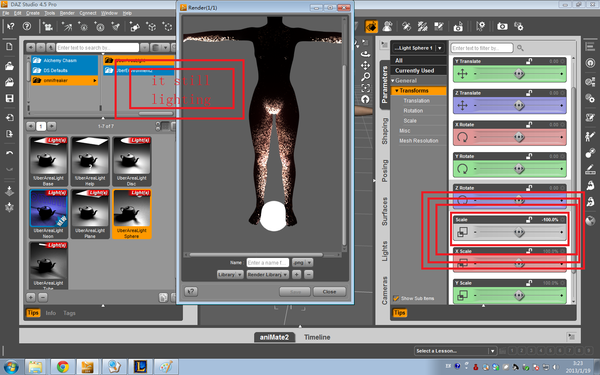

    this is my parameter of sphere
    i already set the scale and z rotare
    but its still not inside out
    1440 x 900 - 551K

  • edited January 2013
    whatever i set the scale postive hundred or negetive hundred
    the lighting always outside not inside

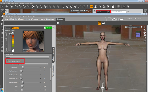

    and what is prograssive render
    i click the camera pic in the top right coner to render
    is does matter?
    so how can i render that?
    Post edited by b9502032_f6fbea2931 on
    i find the progressive render
    and i didt use that
    so what is the problem?
    1440 x 900 - 572K

    I know for sure that is the problem about inside out
    beacuse i craet a defult uber area light sphere
    and i set the sphere's scale -100 but its still lighting
    so how can i do then i can revers the surface
    see the picture
    1440 x 900 - 346K

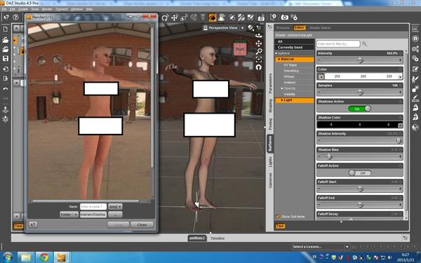

  • KhoryKhory Posts: 3,854
    It is working correctly for me. Be sure that you have ambient checked ON in the surface tab by the way or the inside of the sphere will remain black even though the figure is lighted. Also be sure to adjust the intensity or you will get little or no lighting on the figure. I'll post a render shortly.
    yeah i already checked ON the ambient
    if you didt check on then the whole image you render will drak
    if you checked ON then you can see the background
    but the figure still dark if u put the figure inside the sphere
    because the normal of lighting is outside whatever u set the scale -100 or +100
    I'm using 4.5. Are you raising the intensity on the surface tab high enough? For the render I have going I raised it to 700 because it is a pretty dark image and suspect I could have gone higher. It would depend on what additional light I planned for the scene.
