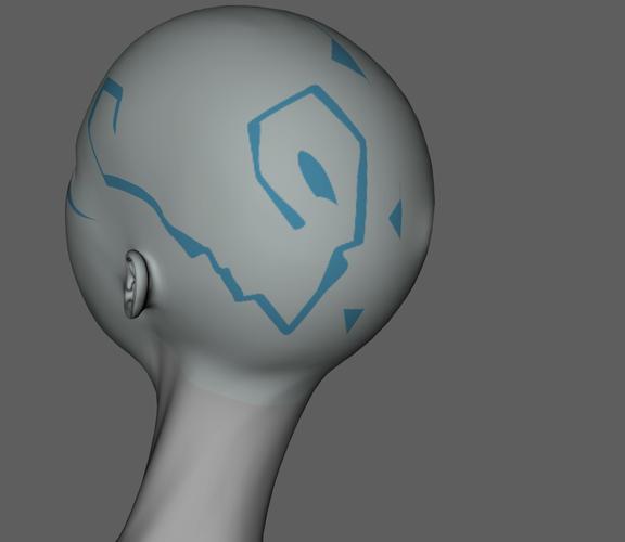

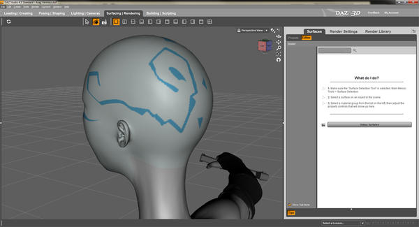

I'm playing around with a Genesis texture, and I'm I'm getting some serious pixelization of my texture on the back of her head.
The V4 textures are 2048x2048, and I've even cranked up the body texture to 4096x4096 in the hopes of smoothing things out, but it even renders like this.
Help!
960 x 520 - 158K

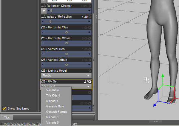

    Have you checked the Surfaces pane under UV Set as shown?
    Genesis is mapped to V4, K4 and M4, as well as M5 and V5, you have to slect the correct UV set for what you are using.

  • baxartbaxart Posts: 0
    In answer to the questions:
    @ Jimmy_C
    Figure is Genesis
    Texture for both the face and back of head, is vector, built in Adobe Illustrator on top of the V4.2 template downloaded from Daz's own site & saved as jpg.
    Have dbl checked the UV map setting & it is set for V4. (I also have the v5 maps, just in case).

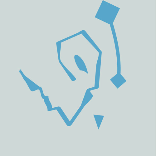

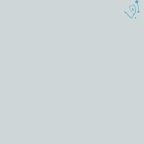

    Body/back of head texture attached & reduced to 2000x2000. Help1 is full tex, Help 2 is just a detail shot.
    As stated above, they're vector at this point, since I'm just trying to get the placement & shapes of the markings/tats correct.
    I know about the low rez texture for workspace thang, but I ran a super slow render and it looked the same. Which drives me nuts because the face looks awesome, the shapes are all smooth, and the back of her head looks like... well... arse.
    655 x 655 - 615K
    2000 x 2000 - 631K

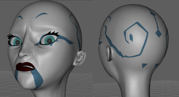

    Okay. I seem to be getting a lot of the same info, so I must not be asking the right question.
    I'm using the V4.2 texture templates from Daz, I've even tried the V5 templates (which have guides and are nicer!).

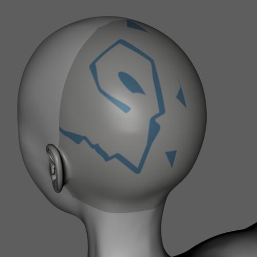

    I know that the display plane is showing a low rez version. (see: help-3 for renders)
    I think Jaderail nailed the problem with the distortion, and IMO the problem is that for what I want to do, the back of the head in the V4.2 texture template is: a) lumped in with the rest of the body skin texture, & b) just too dang small, and therefore my details are getting trashed as the texture is getting blown up and stretched.
    I guess Daz didn't plan on bald figures, but somebody has had to try and make a bald Genesis figure before me, and run into this.
    So, since genesis figure in Daz, allows me to select the back of the head in order to apply a texture, (see: "help-2") then this area must be UV mapped.
    Where can I find a set of UV maps that isolate the back of the head as it's own map (rather than lumping it in with the rest of the body), just as the face/front of the head is isolated?
    1016 x 882 - 199K
    960 x 520 - 208K

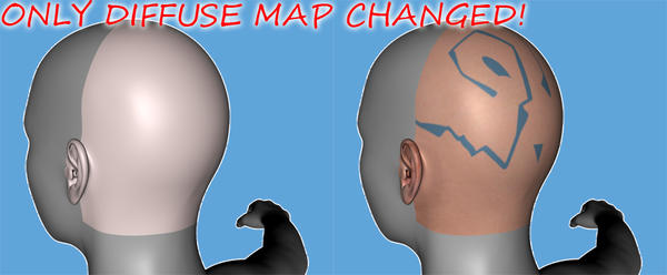

    Okay, been playing around with your texture and I've noticed the same peculiar anomaly. Here's two renders I did changing ONLY the diffuse texture. You'll notice that the tattoo shows up in one of the images but not the other. The positioning of the image hasn't changed, and Daz shows the texture as being in the correct location for the figure in both instances. What's even more interesting is I modified the texture to add in a grid overlay across the entire texture to see if there was some misplacement occurring at render time, but the grid didn't even appear in the render either!
    Very strange behavior indeed. There must be a setting in the material causing it to override the image somewhere. I'll keep playing with it and see if I can find you a solution.
    878 x 363 - 159K
    Post edited by Herald of Fire on
    Okay, curiously enough I found the problem though not at all where I expected it to be. If you click on the diffuse color icon it gives you a list of recent textures and lets you browse new textures. It also has a "Layered Image Editor" function, which you should open up. On the right where it says "Resource" change the color below it to white (255,255,255) and exit out. The texture should now display correctly in the render. I am, of course, confused as to why this is the case but suffice to say it seems to work fine.
    As for detail, it shows up perfectly fine in the final render, as expected of a high resolution texture.

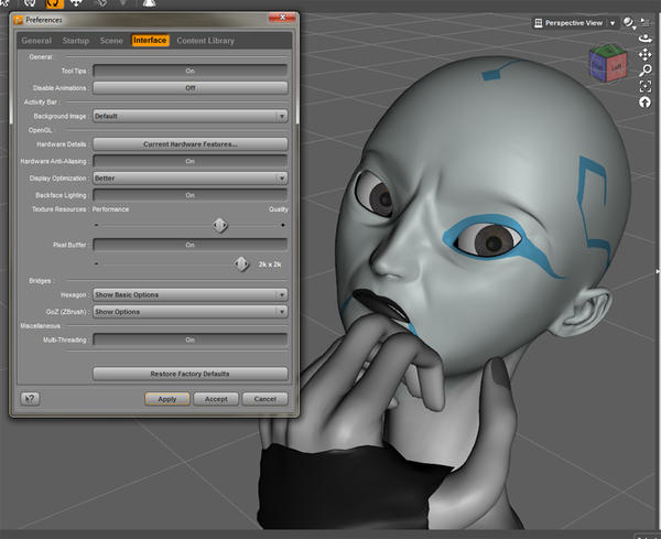

    In help-4 you will see that I have the diffuse color set to white (255,255,255) and I do not have the "layered image editor" function.
    @mjc1016 - I'm trying both 3Delight & OpenGL, but 3Delight makes my textures vanish.
    In help-5 you'll see that I did have AA 'on', and now I've cranked up texture resources (per your advice) & a couple of the other settings too. You'll also see that she's not... very... happy... *gag* *choke* *gasp*
    and in help-6 the latest render. Better... and I might be able to live with it.

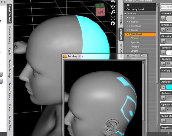

  • kitakoredazkitakoredaz Posts: 3,526
    I feel strange, because if I made PNG tatoo, with alpha value,
    and apply it as diffuse texture map directly on genesis buck skin surface,
    it seems not work. not tatoo area just turn color black.
    so daz diffuse texture value ignore the transparency in 3deligt lender?
    but when I apply the same PNG as layer with other material texture,
    by ILE it work well.
    (but find, when I use the PNG as Ambient color texture,, it more fun for me ^^;)

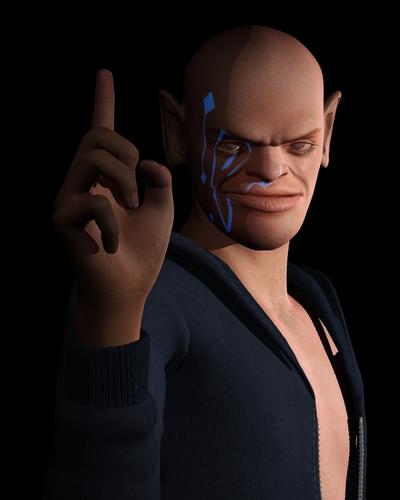

    Ah... so much more better.
    Serious thanks to kitakoredaz for the transparent png idea, so cool!!!
    Here's the new back of head, and face.
    1440 x 780 - 242K
