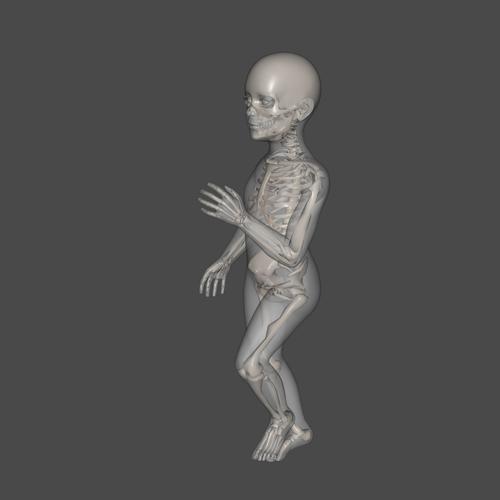

Hey everybody,
I need to create some stills for a client depicting bone deformation on a toddler's skeleton.
So I was wondering if the v4 / m4 skeletons work in DAZ 4.5 and if the "basic child" morph works on the skeleton aswell? Or maybe even the "Genesis Baby" morph?
If anyone has some hands-on experience and could share some info, or maybe even the Daz-Team themselves could confirm compatibility?
Huge thanks in advance!
Cheers :)
  • Richard HaseltineRichard Haseltine Posts: 111,677
    edited January 2013
    The skeletons work, however, AutoFitting to Genesis and then applying the Child morph is pushing things a bit and I would think is going to need a fair bit of tidying up (this is the M3 Skeleton, since the foot position in the Gen 3 figures tends to convert better than for gen 4 figures, but that does need the third generation shapes for Genesis.
    1000 x 1000 - 270K
  • pinkdaemonpinkdaemon Posts: 6
    "Pushing things a bit", hehe, you made me smile ;)
    The pic looks promising and I'd say this seems doable.
    So i'd need to get the "V3 and M3 Shapes for Genesis" along with "V3 & M3 Skeletons" and i'd be good to go?
    Thanks again for the reply!
    Well, the Gen 4 skeletons should convert - it's just that, for some things, starting from a third generation original can give better results.
