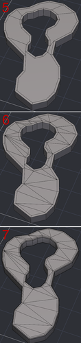

    If you want/need a quick solution, then if you have Carrara, use that, or, you could use Wings3D http://www.wings3d.com/
    In Hexagon, I would create like this:-
    (these are the main steps. If you want to use this method, then just ask if you need more info.)
    1: AI imported curves
    2: Extrude Curves
    3: Add thickness and remove un-needed faces (step used to give good topology on edges)
    4: Use Bridge to cut up produced (in next step) N-gons
    5: Close -> All
    6: Triangulate N-gons
    7: Chamfer if required.
    390 x 1651 - 251K
    347 x 1848 - 278K

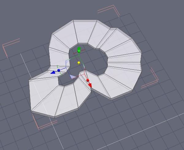

  • RoygeeRoygee Posts: 2,247
    Don't have .ai, so don't know about the compound curves - I took the OP at his word and imagined two whole curves, as I get in Gimp and InkScape. Anyhow, I traced his inner curve in Hex, offset it and used Ruled surfaces, no problem:)

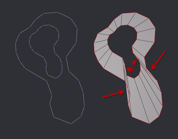

    That is because you offset the inner curve, so you do not get the problem with the shape shown by OP.
    Make the outer shape scaled and offset as shown by OP. You will see the problem.
    Here is example:-
    856 x 667 - 73K
    You are quite right - I stand corrected:)
    Can be a bit of a nuisance untangling the overlapping points, but it is do-able, although your method is less hassle.
