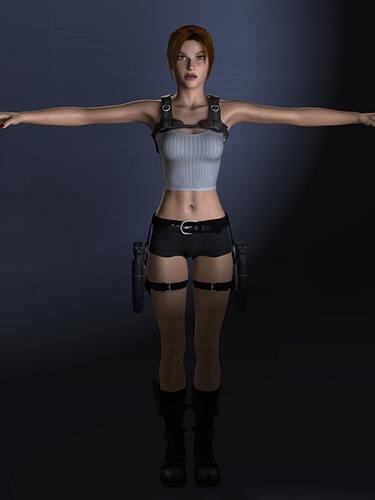

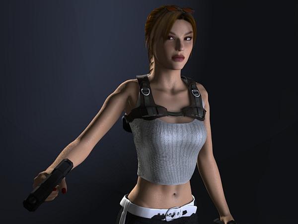

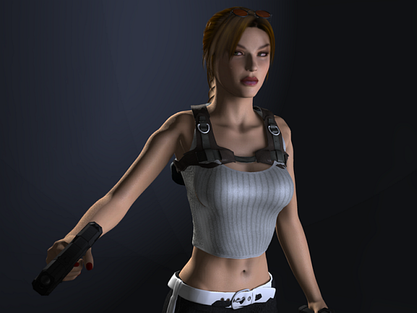

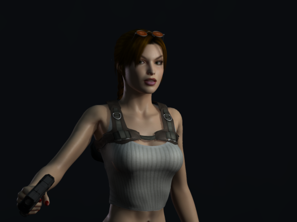

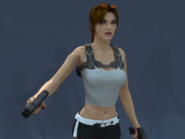

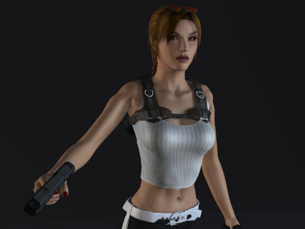

  • 3dOutlaw3dOutlaw Posts: 2,481
    OK, so my lighting in Carrara leaves a little to be desired right now, and I had to reset the face morph, so I lost the expression...but I think this and the next post give you the idea. I tried to make the scenes similar
    This is Poser
    640 x 480 - 110K
    This is Carrara
    640 x 480 - 156K

    Global Illumination always looks "soft" in my opinion, because it tends to reduce contrast.
    AA to Best will look slightly sharper, but at a render time cost
    Set your ambient light to 0... Always... That is the biggest contrast killer.
    *some shader suggestions:
    add a light brown translucency to the hair shader, and a neutral grey translucency to the tank top - will help them both look more touchable and less like "hard clay".
    GI also tends to null out your highlights, so don't be afraid to push highlights on select shaders in your scene, like the metals and the wet parts of her eyes...
    Try putting a VALUE=0-1000 shader in the highlight channel set in the 200 range, control the size of the highlight with the shininess shader (higher values make the highlight sharper/smaller)
    Post edited by wetcircuit on
    So is the Poser render using GI, because it looks like the Carrara render is using it, or at least the Skylight. It might also help to know what compression settings you're using. I also am wondering what your resolution is set to in the Render room? It defaults to 72 dpi which is fine in most cases. I wouldn't lower it, unless you're doing test renders with GI, because it will look fuzzy.

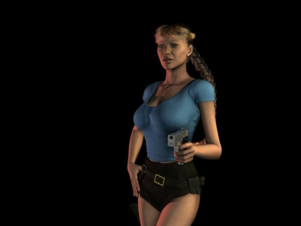

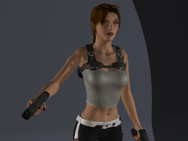

    OK, I switched carrara to a 3 point light setup, with no GI, still trying things, just read Holly's tips...not sure how to get a soft light yet.
    640 x 480 - 119K
    You mean for soft shadows?
    For her skin, check the tutorial at the link in my sig for "Creating Specular Skin Effects"...
    If you have a specularity map you can substitute the Cellular shader in my tutorial with the spec map

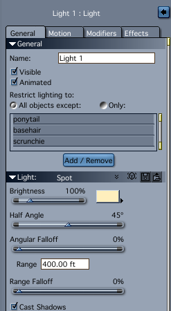

    Softness comes in a few varieties in Carrara, so I'll try to help in this direction using a single Carrara light, the Spot Light.
    Soft Spot part 1 - Shadows
    Many people will tell you to always set your shadow levels to 100%
    You can do this and still get softness. But don't let such suggestions or instructions keep you from dragging that value down some. I use plenty that I set to 33. For light settings aside from brightness, I often find myself using Half, Quarter or Thirds values: 25%, 33%, 50% as a starting point - which is often where they remain.
    Soft Shadows are set in the "Effects" tab toward the top. The light diameter is your softness control. The default is not very soft at .05 ft. or something similar. I like to crank this up to 100 or 150 if it's a spot, or even 3000 for a sun light. Try it at 25 ft. and see the difference. Then try 100 and then 75 or whichever direction you'd like to take your softness. Higher number = softer shadow. EDIT: This setting will change in effect depending upon the distance that the light is - or, in the case of Distant Lights, the distance it's supposed to be. So if you have a streetlight that is 30 ft away from your character, setting this value to 30 ft will give the appropriate default starting point for that soft shadow setting. Please know, however, that too many soft-shadow casting lights can really slow down your render. For this reason, I'll often limit their use for the main figure - and use different softening techniques (not mentioned in this post) for the global scene - if it's needed.
    Soft Spot part 2 - Falloff
    Light angle for the default Spot Light is 45 degrees with 0% Falloff, which is a great default setting - even though I'll seldom ever leave it that way. Falloff is what will create the softness toward the edge of the angle. So for a "Soft" effect, I like to increase the angle and crank up the falloff. But specific shots like yours may benefit from a bit less falloff and angle as well. If I were to make those stark shadows (your brightest light in the Poser shot) using a spot, I would start with the default 45 degrees with a 33% falloff and work from there.
    Light Distance defaults at 400 ft. which will shoot straight past most things in your scene. Most of us lessen this a lot. It's the falloff that provides softness magic here as well. Leaving it at 400 ft and turning the falloff to 90% is still going to nail your character with light, if it's anywhere near her. Instead, try keeping the Spotlight relatively close to your figure - say, within 10 to 15 ft, and set the distance to two or three times that amount and set your falloff to something around 50%. Distance falloff is very neat because it can actually stop the light from reaching your figure - depending upon these settings and where the light is placed. It's really fun to tweak this along with the above mentioned Angular falloff.
    Edit: In the example of your Poser image, distance falloff is entirely unnecessary - as the light should still be strong as it passes the figure. But this setting also plays a big part in helping to soften things up.
    Soft Spot part 3 - Brightness/ Scene ambiance
    Brightness is the final step to get you the softness you really want. between the actual brightness level you set on the slider, and the color you select in the box. For a white light, for example, it's fun to test changes in brightness using the grey-scale of the color box in conjunction with the value slider. Work with this stuff after you've already set your shadows and falloffs - but then go back and tweak those, if you like.
    The final thing I'll say about softness in this post is regarding scene ambient light. You can soften most anything by tweaking this setting - but experimentation is in order. Many folks like to start with a simple small plane and a few Spheres, Cones or Cubes in an otherwise empty scene just to see the effects. If you do this, save off your light rig first, so you can use it for this test.
    Anyways, what scene ambient light does is to fill shadows with color on a global scale. To achieve a similar effect on a local level (just the figure, for example) you can use lights that don't cast shadows. In both situations, I suggest starting with the value set to 15 (15 brightness on a light) and go for a color that is very close to grey-scale - but you can take it into the color as much as you like - and is around half way between white and black on the color triangle. We're going for subtle here. Darker, less saturated colors in combination with low values on the slider will achieve closer to no effect at all, while still helping you soften your shadows. Like Holly explains, I'd set this to 0% to achieve the same, stark shadows of your Poser image. I just wanted to give you some well-rounded help.
    Hope this helps

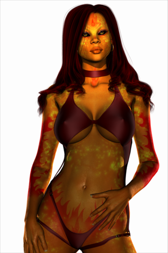

    edited January 2013
    Something I'll do sometimes is copy the texture map from the color channel into the glow channel and set the maps brightness to 10% or lower. Helps with the iris and whites of the eye as well. I like to use it to fake SSS.
    It can take sometime to set up, but once I'm done, I then save the shader to my browser for later use.
    Here's an early test of the method. No GI or Skylight.
    1500 x 2000 - 803K
